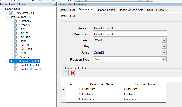

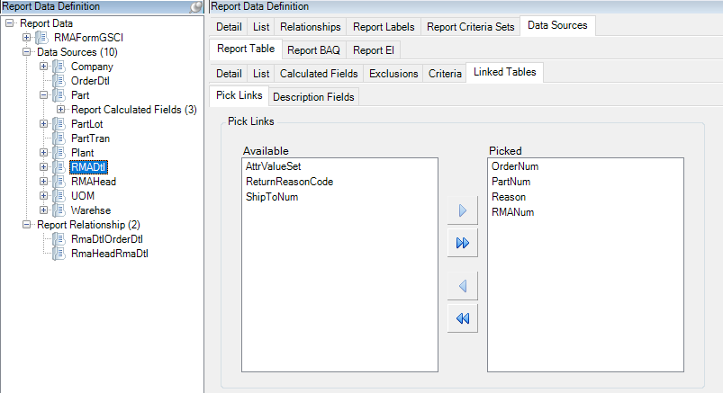

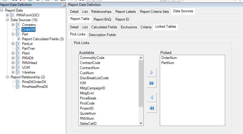

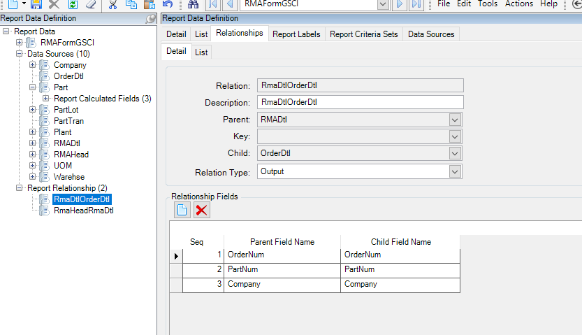

I have already added the OrderDtl table to the Report Data Definition, as shown in the image below:
If the relationship is correct, I need to update the SSRS expression accordingly.

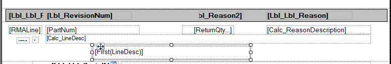

Hello Greg,
Thanks for your help.
I tried following the steps you provided, but it didn’t solve my problem. I updated the Query.CommandText to the following, but nothing is coming out in the print preview, not even an error message:

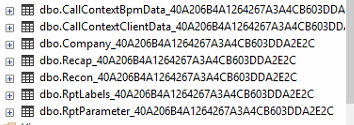

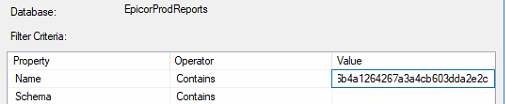

Since you are OnPrem, if you give the report an archive time then you can get the guid from the task monitor to verify the field is being created.
ssms filter views of the report database
The tables created for the report. In your case you want to see the OrderDtl here and can open to find your field.

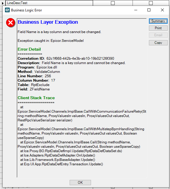

Hello!
I tried the pattern by making table T3, however, I couldn’t change the field name. I got this error message instead:
Sorry, but I am not a developer. I am trying to customize it using what I’ve learned from the Epicor training, and roughly it was:

You are not changing theirs. Add one with something like Odtl_LineDesc.

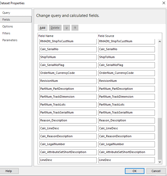

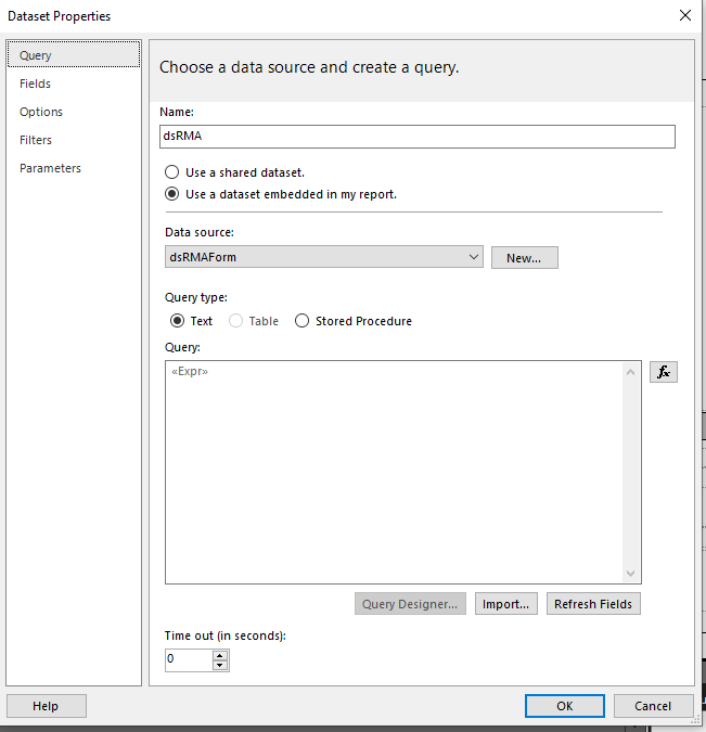

Here is my query:

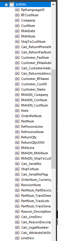

(I am bolding the text I’ve added to it and I’ll post a few screenshots of the RDD just to give you a full picture)
