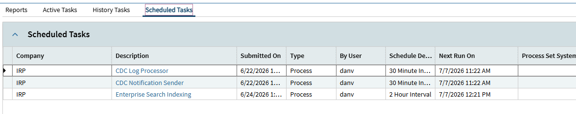

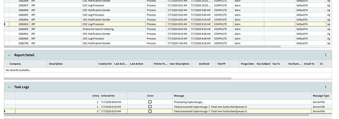

I believe I have accurately followed the documentation that I can find. CDC task and Enterprise Search Indexing are scheduled and have been running for several weeks -

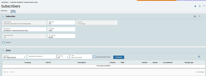

An Enterprise Search Index Subscriber is present in Subscriber management. I presume that this was added automatically when the search index was created. I note that there are no rules listed and have found no documentation specifying creation of rules for Enterprise Search Index.

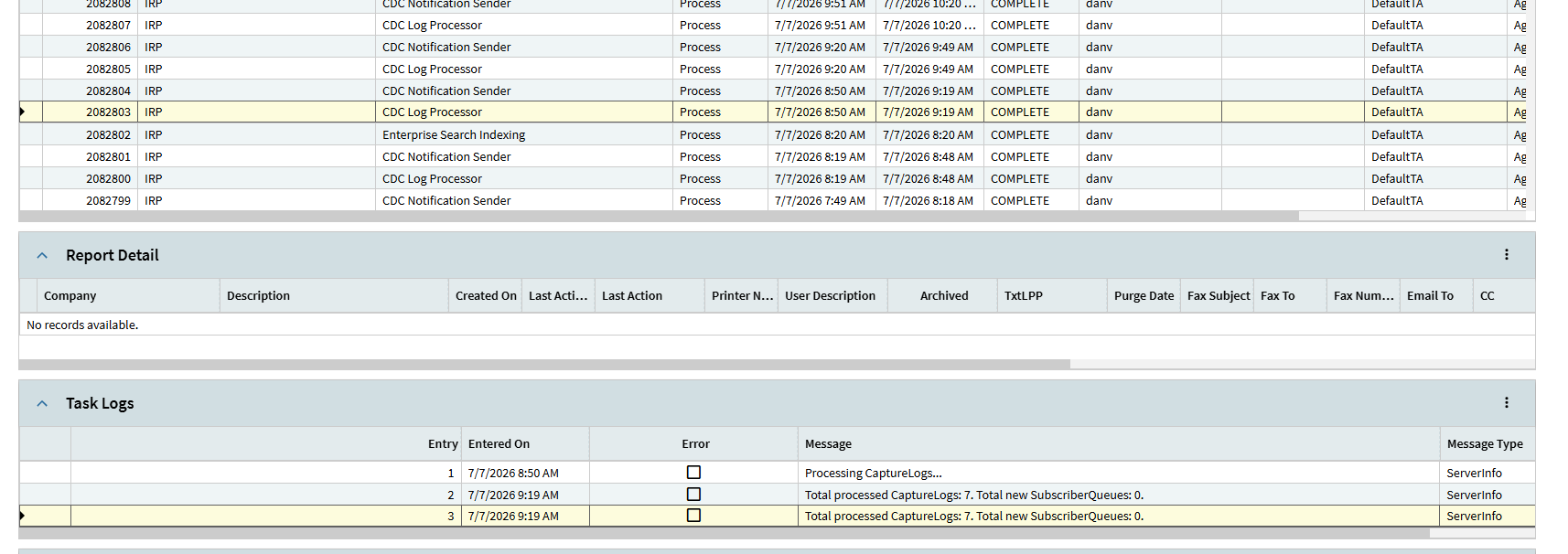

This morning about 8:30 a.m. I added a line to an existing order. I believe that may have been captured by the CDC Log processor at 08:50.

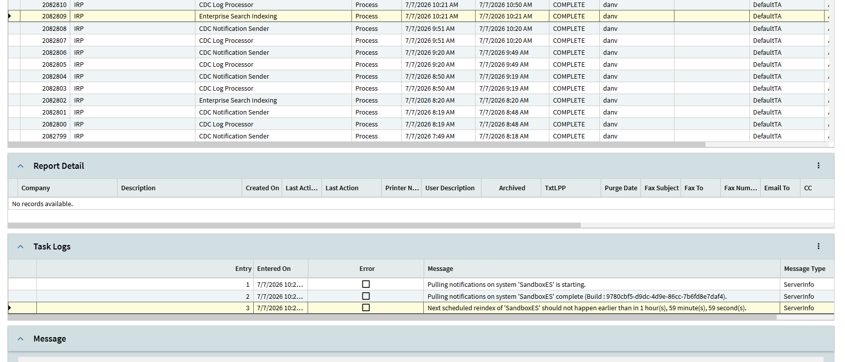

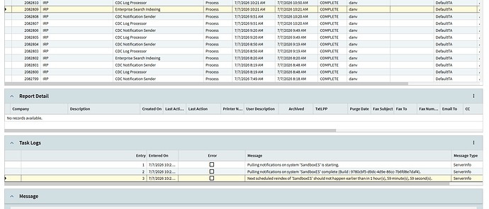

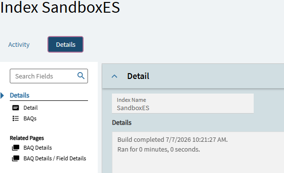

The index process then began at 10:21.
That build did not indicate that it picked up anything -
A search of the index does not find the newly entered order line.
