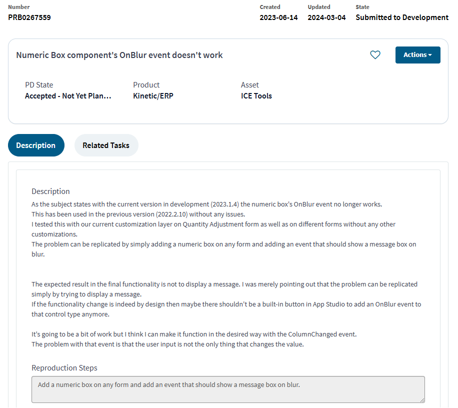

Then I see I am not alone here and it is an existing PRB.
So is it still broken in 2025.2, for example? That PRB implies it is not fixed, but occasionally they fix issues and don’t clean up those PRBs.

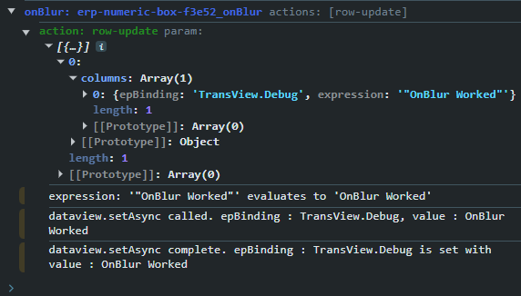

I just tested a numeric box onBlur in my Pilot 2025.2.16… worked fine there.
I had previously switched a bunch of mine over to ColumnChanged events to get around the onBlur issue. But it seems to work now.

I tried - just to test it - on a textbox and it was fine. I mean, I am sure I have used onBlur before for something.
So is it MORE broken in your version??
No, that was a good while ago. I had textbox onBlurs that broke so I switched them all over to ColumnChanged events.
But both textboxes and numeric boxes seem to work okay in 2025.2.16. Could have been fixed prior to this… that’s just what I have to test with at the moment.
