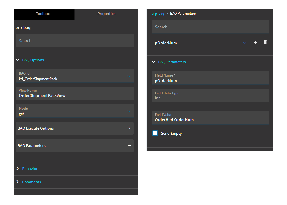

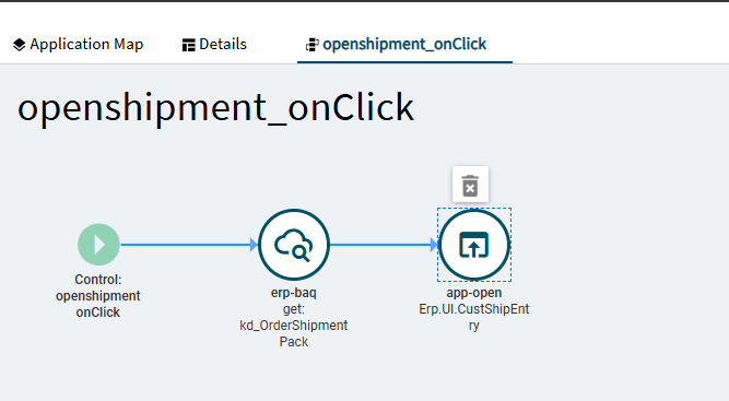

I already have a button that creates a shipment from an order in Erp.UI.SalesOrderEntry. I want to create another button that opens the shipment for the order in a slideout panel. PS: This is a 1 to 1 relationship so there will always be only one Pack for each order here.
I have created BAQ to pull this information but not sure how I can wire it to app-open.
Button Flow
BAQ Options and Parameters
app-open parameters
In Launch Options, I tried below which didn’t work

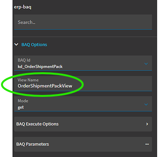

Try
"options": {
"valueIn": "{OrderShipmentPackView.ShipDtl_PackNum}"
dcamlin
(David Camlin)
March 25, 2026, 11:53am
3
I had this typed up and then got a phone call and got distracted… but I came to the same conclusion and agree with @jbooker …
Based on your BAQ event, the results of your BAQ should be getting pushed into this dataview:
So, I assume your launch options should be:
"type": "Erp.Lib.Framework.LaunchFormOptions",
"options": {
