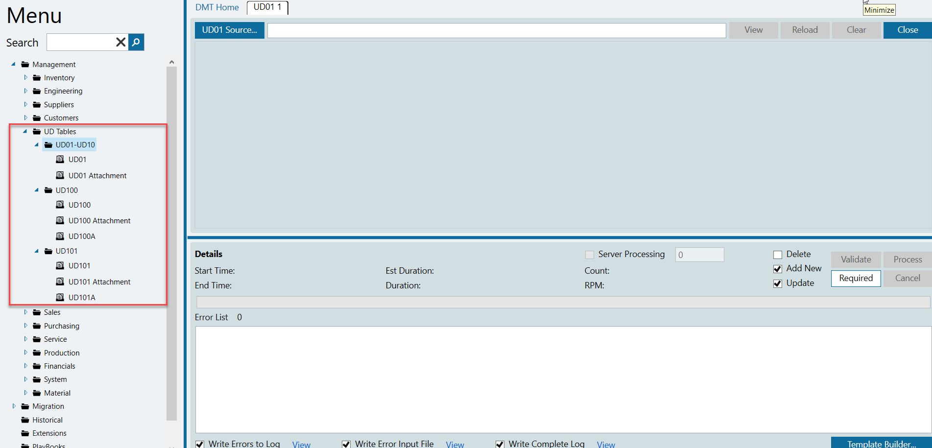

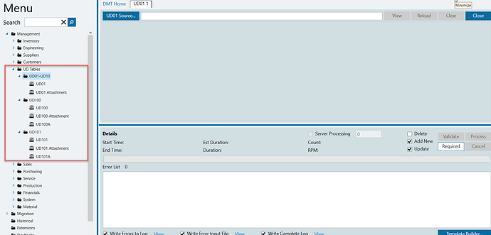

Open UD DMT
Why does the UD table in DMT only have this many fields? How can I open other UD fields?

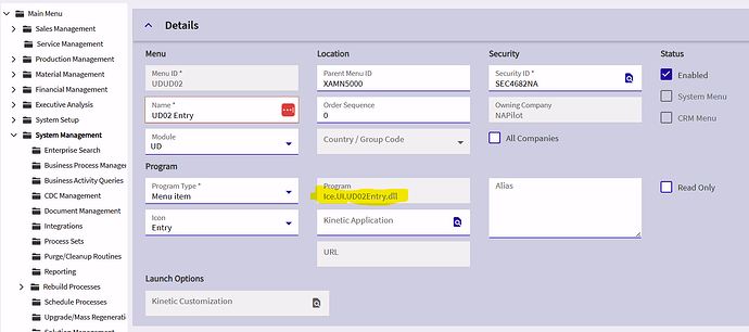

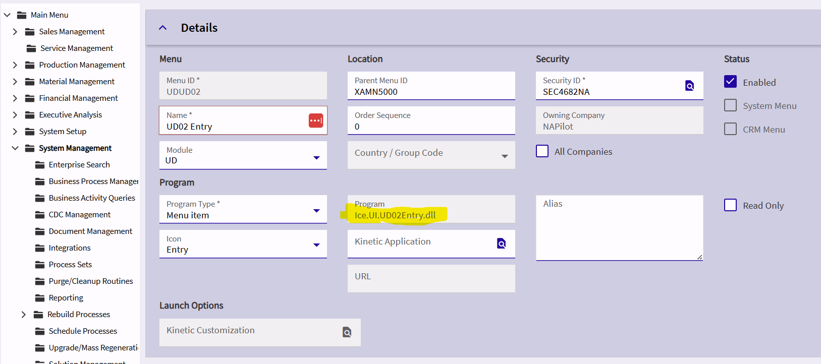

it appears in DMT only when you create UD table entry in menu maintenance
In Menu Maintenance, add an entry like this one. I put it under System Management because only our Security Managers will ever need to DMT UD02:
