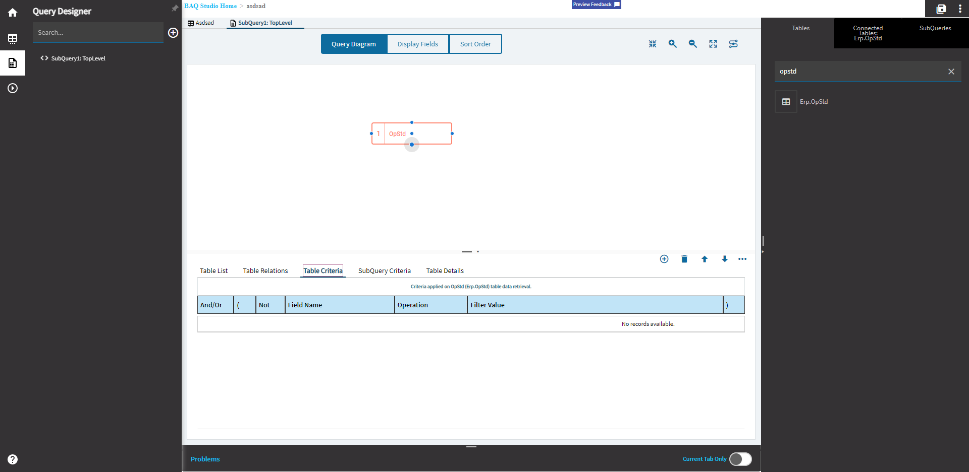

I vaguely remember an E10 setup table called Operation Standard, where you could predefine the run time budgets for a particular operation. It’s MIA in Kinetic, does anyone know a) why, or b) a good workaround - other than the obvious, creating a template MOM?
I see it in 2021.2 as well as 2022.2.
Interesting! Wonder why they removed it from the menu and the programs that use it?
Interesting indeed…

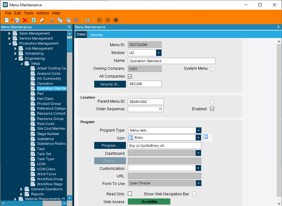

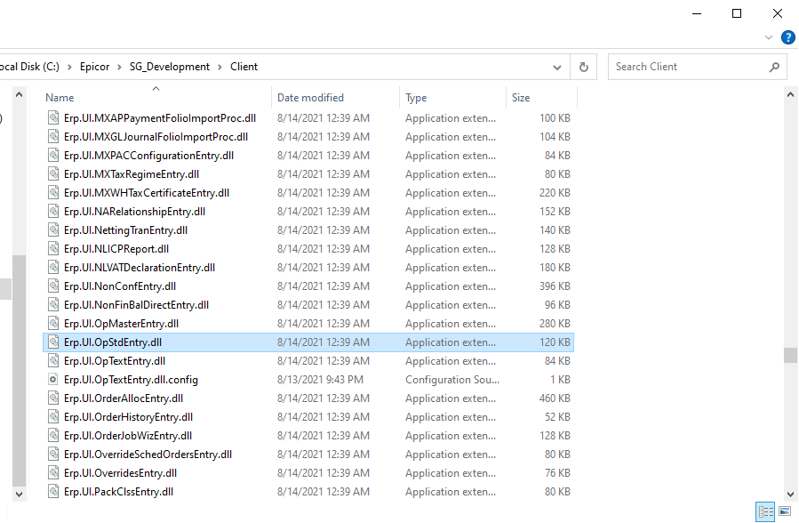

Upon further investigation, it exists, but they removed it from the menus for some reason???

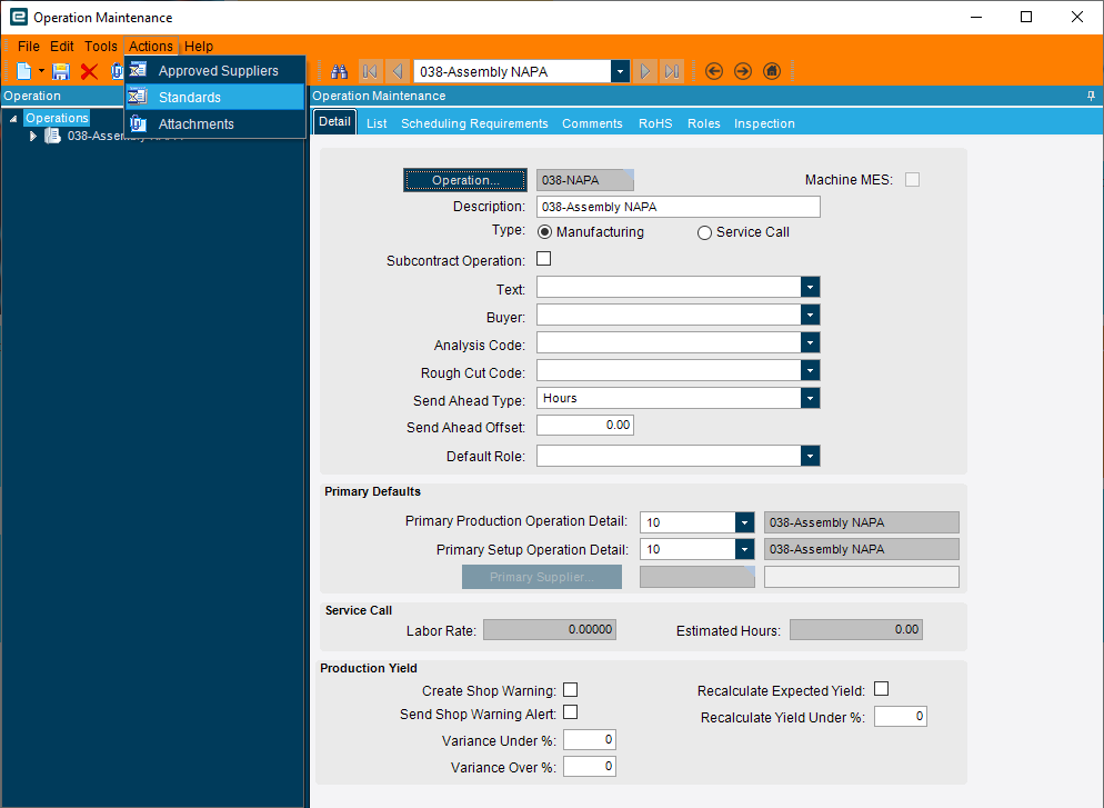

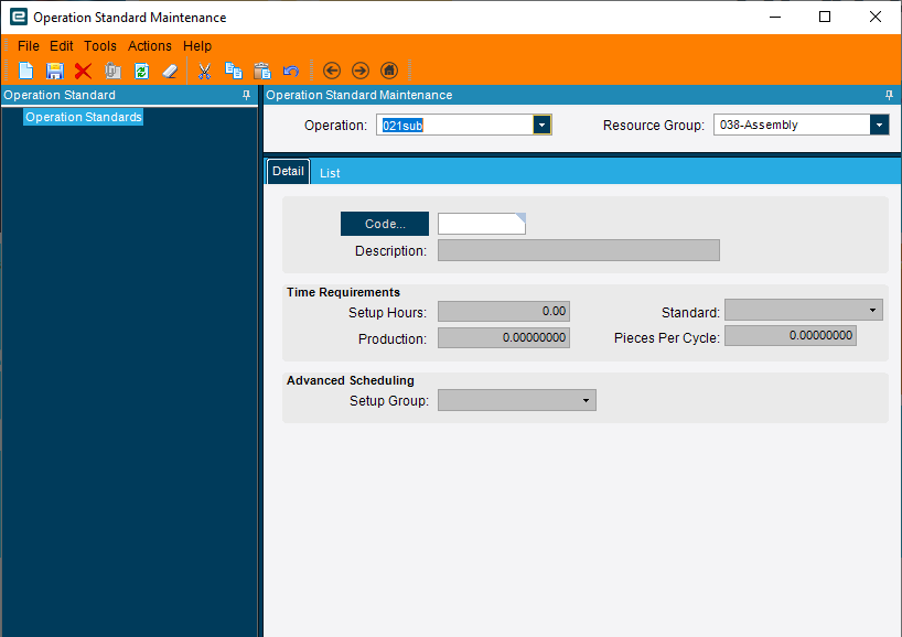

You can add it back, however.
:face_with_monocle:
:thinking:
:woman_technologist: :
:partying_face:

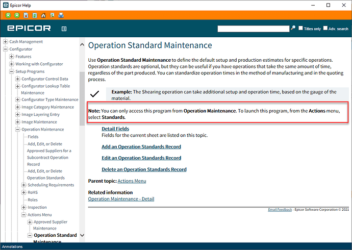

Mystery solved.
Thanks Hannah! I still think it’s odd it’s not searchable or there in the Setup menu…I mean it’s a setup table just like all the others. I had forgotten how to get to it.
