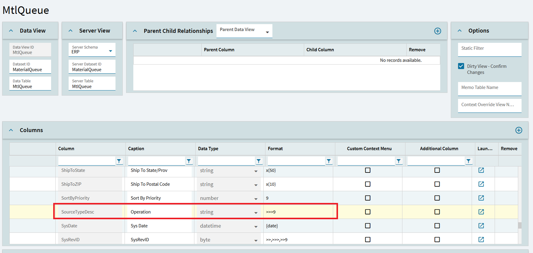

Has anyone ever wanted or tried to get the Operation into the Material Queue Manager? I have tried many ways of getting it to load into the MtlQueue Dataview with no luck. I am starting to think it isnt possible. Any ideas??
Its there, you just have to unhide it in personalize columns and its called jobseq.

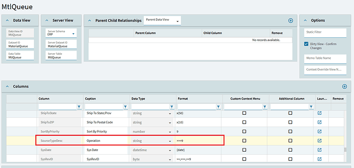

Unfortunately, when I go toggle that on it only gives me the MtlSeq. I ended up getting it in there though. I used an existing row that we were not using in the MtlQueue Dataview called SourceTypeDesc and I labeled it Operation (See Screenshot). I then had to make a BPM that would substitute the operation into that field. BPM is Below.
// Populate Material Queue Operation display field
// BO: Erp.BO.MaterialQueue
// Method: GetRowsCustomParams
// Type: Post-Processing
foreach (var q in **result**.MtlQueue)
if (string.IsNullOrWhiteSpace(q.JobNum))
continue;
if (q.JobSeqType != "M")
continue;
if (q.JobSeq <= 0)
continue;
var jm = Db.JobMtl.FirstOrDefault(m =>
m.Company == q.Company &&
m.JobNum == q.JobNum &&
m.AssemblySeq == q.AssemblySeq &&
m.MtlSeq == q.JobSeq);
if (jm == null)
continue;
q.SourceTypeDesc = $"Op {jm.RelatedOperation}";
