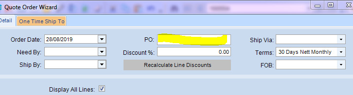

I am trying to implement a pre proc BPM on the OrderHed. Basically I want to warn the user if the PO number has been used already. I want to use the OrderHed.PONum here;
But if I enter an already used number I get no warning.
If I change the OrderHed.PONum here;
I get the warning.

Hi @A.Baeisa, what I am trying to do is validate the PO at the Create Sales Order Wizard stage, most users enter the Customer PO here if it is not already populated from the quote.

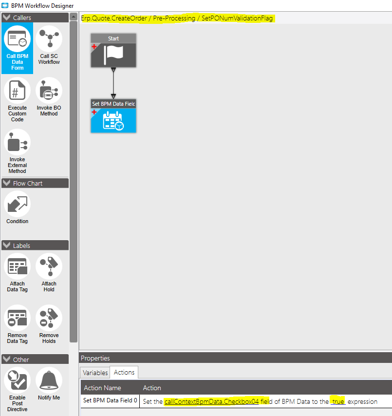

Ok mate, since that you want to trigger the validation process at this CallProcessScreen then the easiest way -in my opinion- is two BPM’s using widget will do that for you and no need for code, as per the following:
  1. Pre-Process method BPM on Quote BO CreateOrder method ( this is your trigger)

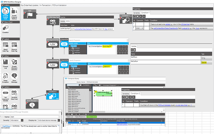

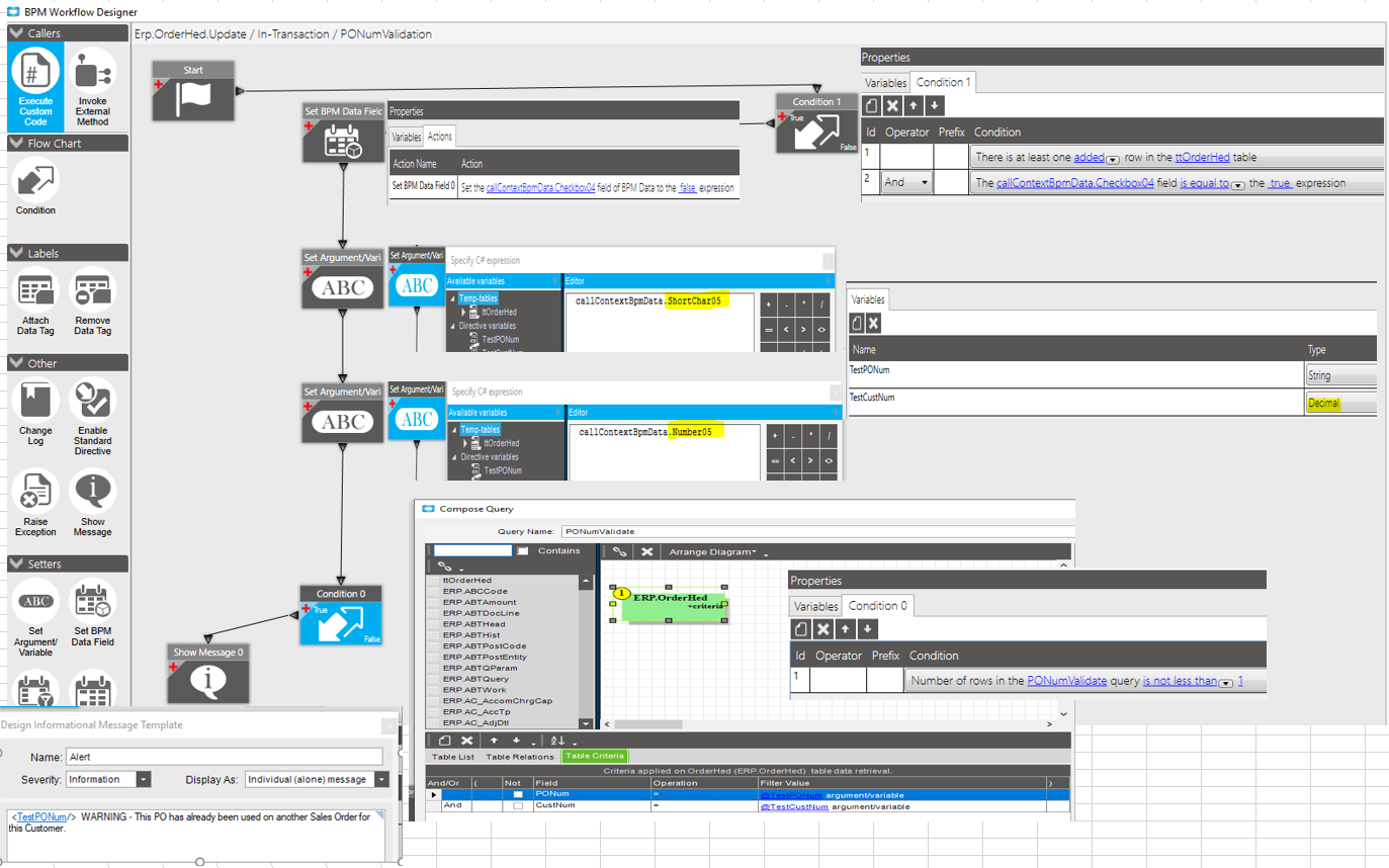

  2. Another In-Transaction Data BPM on Sales Order Head , it will check if there is at least one added record on this table [OrderHed], if yes it will assign two argument variables one to the ttOrderHed.PONum and the other one to ttOrderHed.CustomNum then it will check if there is any sales order within the database has these two criterias, if there is it will warn the user at this transaction.
HTH

no problem mate, i have found an issue on the ttOrderHedRow.CustNum and the ttOrderHedRow.PONum, so i have modified the variable assigning on the second BPM from these ttValues to CallContextBPMVariable :
and at this ProcessCallScreen form i.e. (CreateOrderWizardForm) i have capture these CallContextBPMVariables at before method call adapter, this is the customization code from the script editor:
// Custom code for CreateOrderWizardForm
// Created: 29/08/2019 11:22:49
using System;
using System.ComponentModel;
using System.Data;
using System.Diagnostics;
using System.Windows.Forms;
using Erp.Adapters;
using Erp.UI;
using Ice.Lib;
using Ice.Adapters;
using Ice.Lib.Customization;
using Ice.Lib.ExtendedProps;
using Ice.Lib.Framework;
using Ice.Lib.Searches;
using Ice.UI.FormFunctions;
public class Script
	private EpiBaseAdapter oTrans_adapter;//AB
private EpiDataView edvOrderHed;
		this.edvOrderHed = ((EpiDataView)(this.oTrans.EpiDataViews["OrderHed"]));//AB
		this.oTrans_adapter = ((EpiBaseAdapter)(this.csm.TransAdaptersHT["oTrans_adapter"]));//AB
		this.oTrans_adapter.BeforeAdapterMethod += new BeforeAdapterMethod(this.oTrans_adapter_BeforeAdapterMethod);//AB
		this.edvOrderHed = null;//AB
		this.oTrans_adapter.BeforeAdapterMethod -= new BeforeAdapterMethod(this.oTrans_adapter_BeforeAdapterMethod);//AB
		this.oTrans_adapter = null;//AB
		// Begin Custom Code Disposal
		// End Custom Code Disposal
	private void oTrans_adapter_BeforeAdapterMethod(object sender, BeforeAdapterMethodArgs args)
		switch (args.MethodName)
			case "CreateOrder":
			System.Data.DataRow edvOrderHedRow = edvOrderHed.CurrentDataRow;
				if (edvOrderHedRow!=null)
				var vCustPONum = edvOrderHedRow["OrderPONum"];
				var vCustNum = edvOrderHedRow["CustNum"];
				EpiDataView edvCallContextBpmData = ((EpiDataView)(this.oTrans.EpiDataViews["CallContextBpmData"]));
				System.Data.DataRow edvCallContextBpmDataRow = edvCallContextBpmData.CurrentDataRow;
				if ((edvCallContextBpmDataRow != null))
					edvCallContextBpmDataRow.BeginEdit();
					edvCallContextBpmDataRow["ShortChar05"] = vCustPONum;
					edvCallContextBpmDataRow["Number05"] = vCustNum;
					edvCallContextBpmDataRow.EndEdit();
			//MessageBox.Show("Hi Ali"+"_"+vCustPONum+"_"+vCustNum);
				break;
make sure that these callcontextBPM variables are not in used and clear them at the end of this BPM, please let me know how it goes
