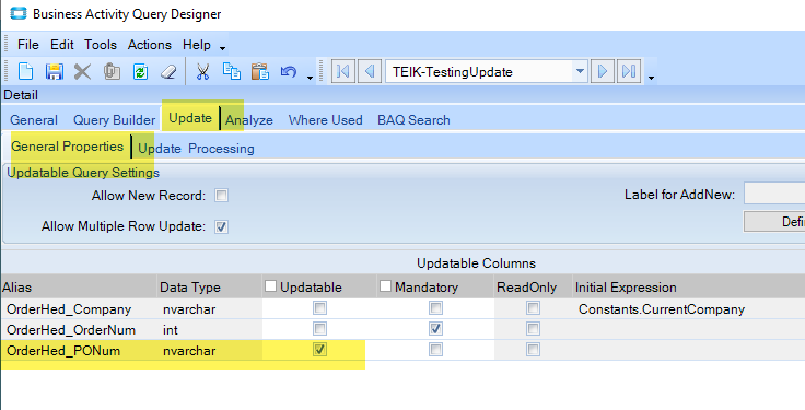

One other idea is an updateable query. I ran a test and it allows change of customer PO number on the OrderHed data even after the order has been closed. It could be a limited / simple dashboard where user enters sales order number and it shows PO field and they update and save.

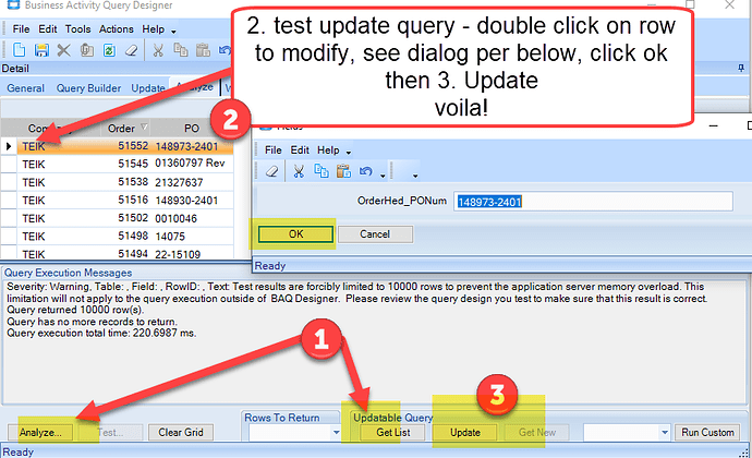

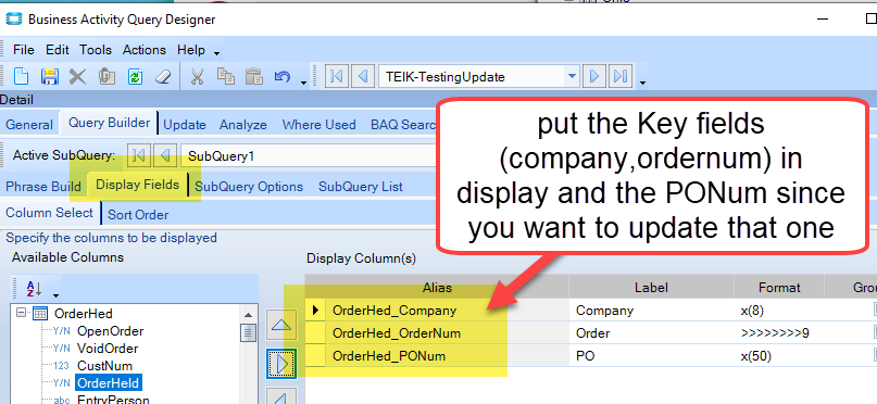

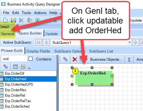

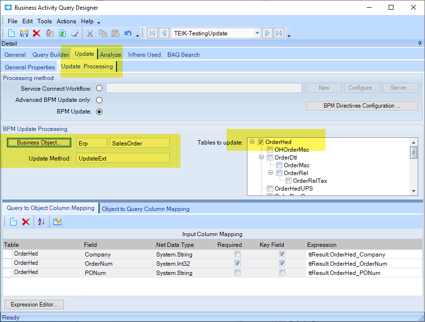

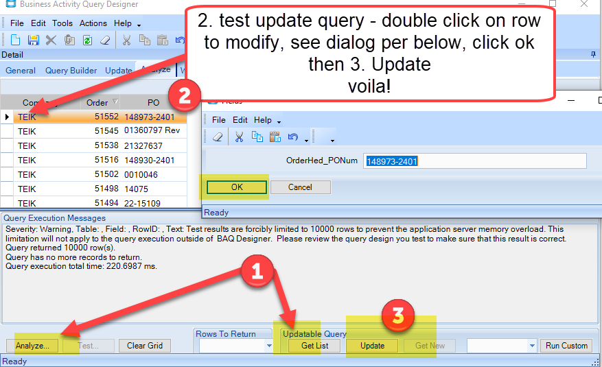

Hi Mark,
Sure, see screenshots below. Of course, as Ernie mentioned, testing it through shipping and invoicing would be an exercise in due diligence! I suspect this edit will be ok to do, but good testing should never be skipped. Also, in a dashboard I’d put a filter in for the sales order number desired to modify, and consider limiting who is allowed to do/run it via menu permissions.

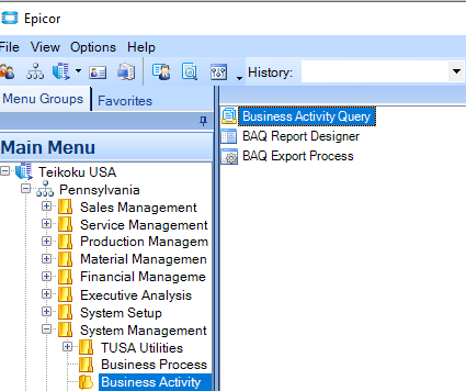

One more question - how do I find the Business AQ designer?

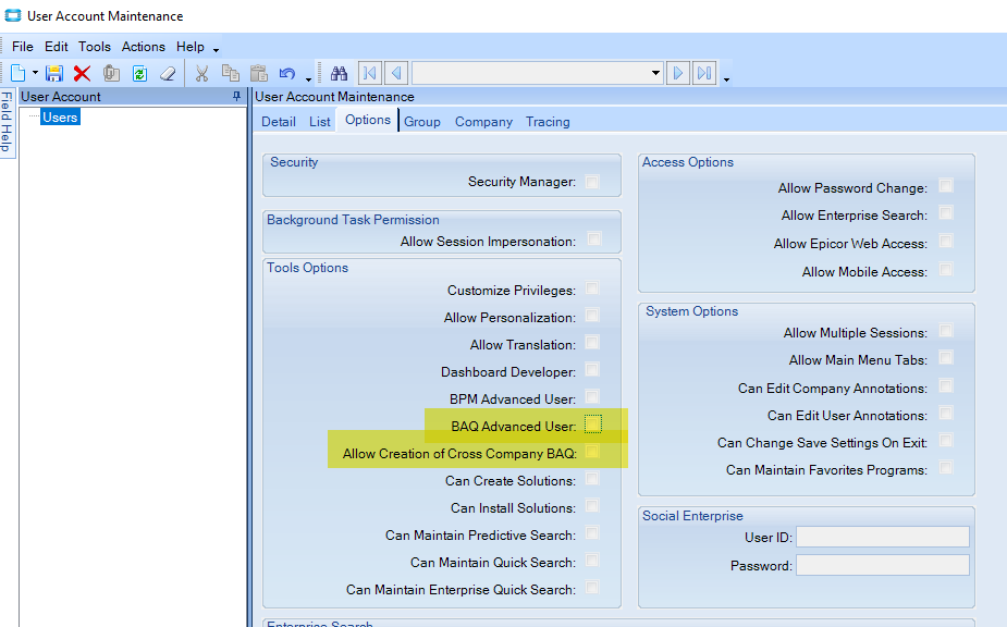

Hi Mark,
In my version 10.1.600 it’s under System Mgmt folder per screenshot. Also, to make the query you need privileges to do so under user account maintenance. I admit I feel a little worried that your first work with queries in Epicor will be an updateable one. I do recommend testing / learning in a test database. With great power comes great responsibility :sweat_smile:

It seems I cannot check the Updateable box.
Any idea why?
Mark
Update your user account option first… “BAQ Advanced User” = true?
Thanks, that’t it.

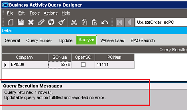

I did as suggested by Nancy.
Steps 1-3 all work fine but after Update the actual PONUM - when I check the sales order tracker - is not updated.
I forgot something?
TBD… after you tried to update
did you receive a confirmation in the query execution messages?
Also… not sure what version you are running but… here is a simple UBAQ for E10.1.6 if you want to try importing/testing.
UpdateOrderHedPO.baq (19.4 KB)
Hi,
There was indeed another BPM that prevented the update.
It is now all working, perfect!

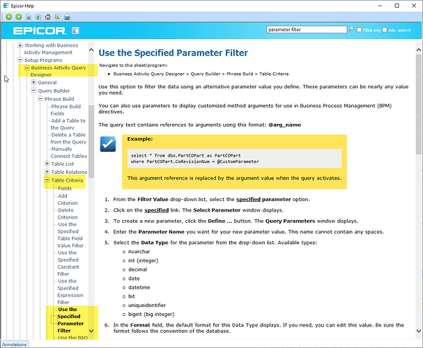

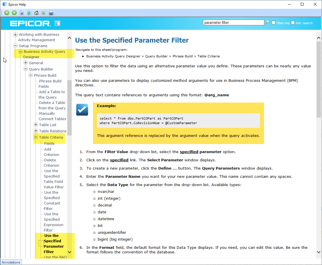

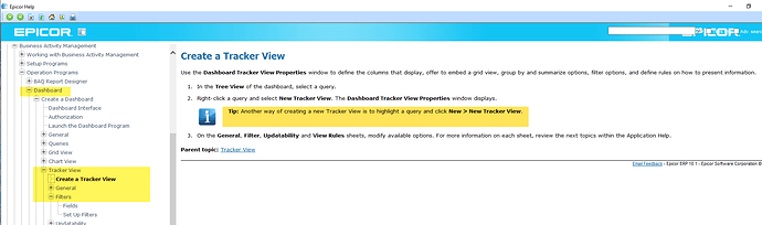

Hello, coming back to this question I wonder if it is possible to select the applicable order I want to adjust before the analyze/get list action. I now get all orders when I hit get list and need to scroll down looking for the one I need. I also have more than 10000 rows so don;t see some at all.
Mark
Hi Mark,

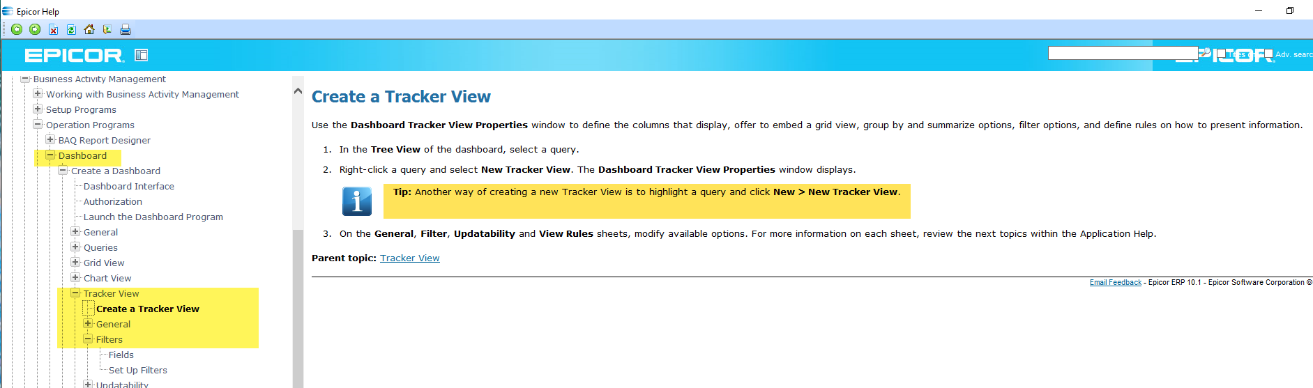

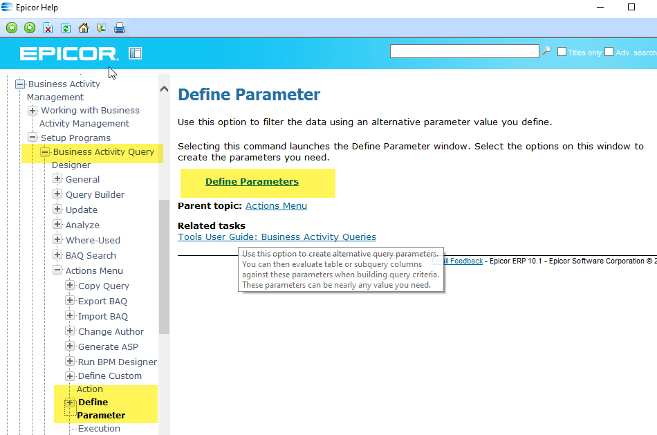

Did you end up making this a dashboard? If so, then you may add a dashboard query filter. This will provide a field for you to enter or search for desired sales order number. Alternately, you could add a parameter to the query for the sales order number and then when you refresh the dashboard or query, it’ll prompt for sales order.
If doing filter in dashboard, use a tracker view to apply the filter. Here’s guidance on it from Epicor help. Also, there are many examples in this help site. Look for filter tracker dashboard.
If you want to put the parameter directly on the query run, without dashboard filter field, also from Epicor help:
