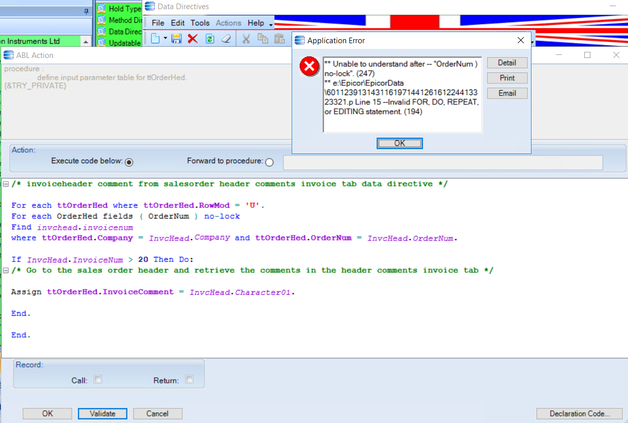

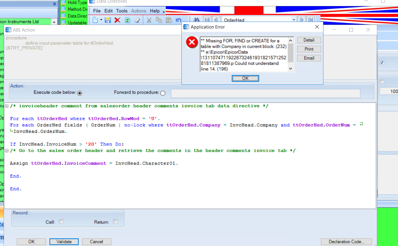

Decided to go down the ABL route but getting this error:
/* invoiceheader comment from salesorder header comments invoice tab data directive */
For each ttOrderHed where ttOrderHed.RowMod = ‘U’.
For each OrderHed fields ( OrderNum ) no-lock where ttOrderHed.Company = InvcHead.Company and ttOrderHed.OrderNum = InvcHead.OrderNum.
If InvcHead.InvoiceNum > ‘20’ Then Do:
/* Go to the sales order header and retrieve the comments in the header comments invoice tab */
Assign ttOrderHed.InvoiceComment = InvcHead.Character01.
End.
End.
must be getting closer?!
also, once the syntax is correct, which table should this sit against in the data directive…orderhed or invchead?

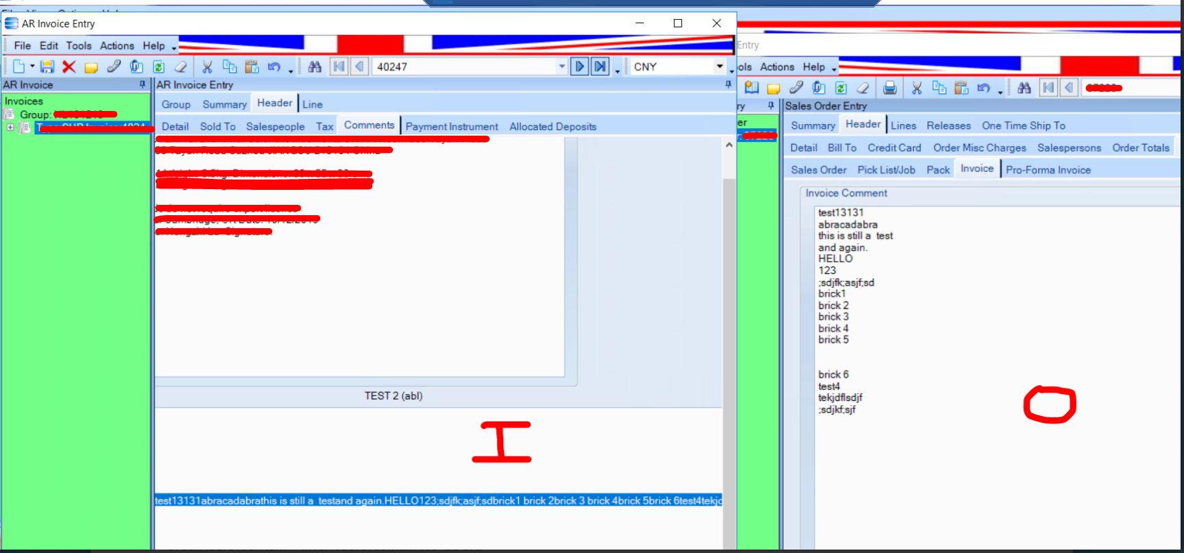

it seems to work but the refresh time of clicking save on the order is quite a while which concerns me i’ve got something wrong:
