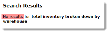

A lot of what my company has demonstrated interest in, is fairly specific and won’t exactly appear in the Epicor Help:
I just need a little guidance because I don’t know every possible corner of the Epicor system.

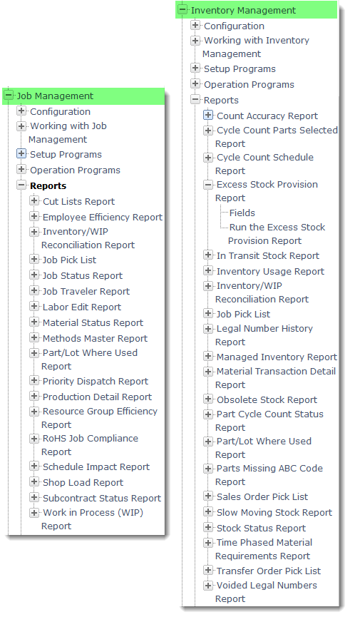

I’m also looking through a few of these Job Management and Inventory Management Reports, as well:
