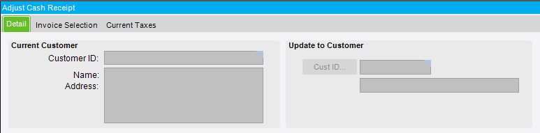

Not sure what version you’re on Julieann, but starting at some point after 10.2.100, Epicor added the Adjust Cash Receipt command that gives the ability to move a cash receipt to another customer. Reverse Cash Receipt might work as well.
HI Mark
yes I saw the Adjust Cash Receipt but that too isn’t allowing the adjustment becuase of the two different customer accounts. Anything else you can think of?
thanks

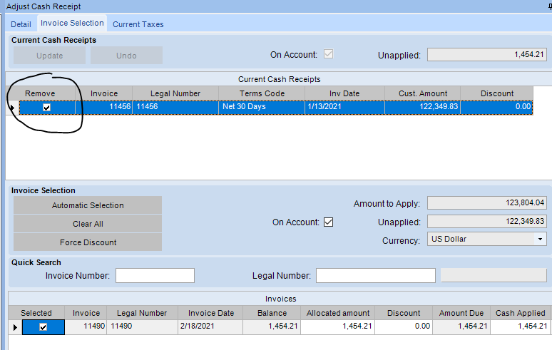

But the thing is we want the payment to stay on the first account because it pays an open invoice, we only want the overpayment “unapplied” amount to go to the second account. When I do the selection part it’s showing that it will “remove” the first account/invoice and we do not want that to happen.
I think it’s removing it because the On Account box is checked.
Might be better to reverse it all and then apply it in two deposits.
ok I’ll make that suggestion
