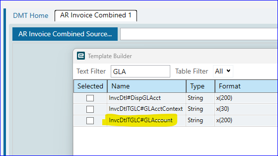

Hi David thanks so much for your response, I believe it’s getting DMT’d into AR Invoice combined, the actual GL Field name I need is within AR Invoices, in Line/Detail.
thanks!

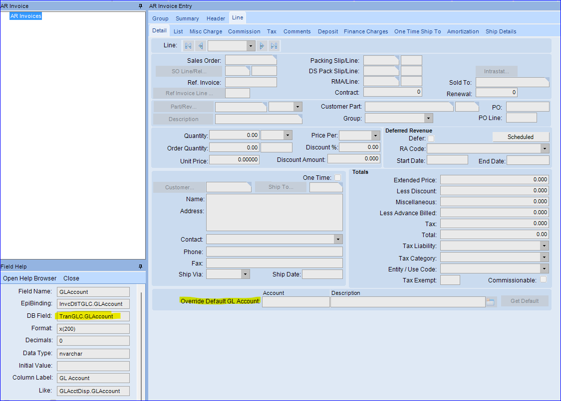

You could test against this one…
… actually, I highlighted the wrong one… you need the EpiBinding.
Try this one on AR Invoice Combined template:
Thanks David, that’s really helped!
I feel like i’m looking in the right direction now, unfortunately when I’ve filled the sheet out under the “InvcDtlTGLC#GLAccount” Epicor doesn’t seem to like the format, as when I DMT the sheet - all columns Validate but when I “Process” it, Epicor says “Please review GL Account format” - Apologies, im very new to all this haha
