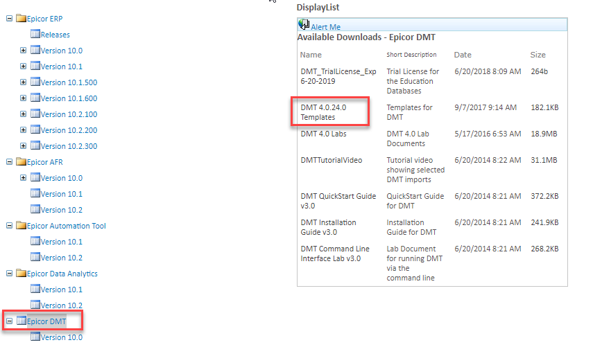

@lmeeks - Mike makes a good point - do you have the DMT Templates? If not, you should download them. I’ve got them and can confirm that there is a APCombined.csv template file - and like 50 more covering all aspects of DMT that you can’t find in the UI.
Here is the current EpicWeb folder. Doesn’t look like they’ve been updated in a while…
