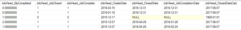

You can use case structure like this. Review attached sample to start with. modify per your requirements.
[JobHead].[JobNum] as [JobHead_JobNum],
[JobHead].[PartNum] as [JobHead_PartNum],
[JobHead].[ProdQty] as [JobHead_ProdQty],
[JobHead].[QtyCompleted] as [JobHead_QtyCompleted],
[JobHead].[JobClosed] as [JobHead_JobClosed],
[JobHead].[JobComplete] as [JobHead_JobComplete],
[JobHead].[CreateDate] as [JobHead_CreateDate],
[JobHead].[ClosedDate] as [JobHead_ClosedDate],
[JobHead].[JobCompletionDate] as [JobHead_JobCompletionDate],
**(case **
when JobHead.JobClosed =1 then cast(getdate() as date)
else ‘01/01/1900’ – this is blank date
end) as [JobHead_ClosedDateCalc]
from Erp.JobHead as JobHead

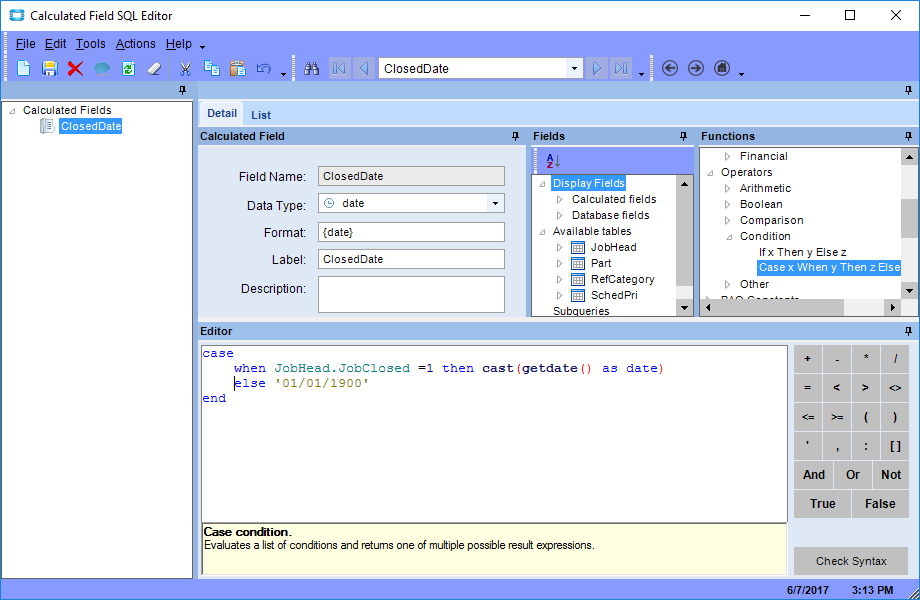

How would I do this within the Business Activity Query Designer?
EDIT: I see that you put [JobHead_ClosedDateCalc] so I assumed it was a calculated field? I tried playing around with the calculated field editor and adding the information you bolded but couldn’t find the correct syntax.
Try like this.
That doesn’t work.
A few things: “when jobhead.jobclosed =1” doesn’t work/tie to JobClosed so it just makes every one 1/1/1900. Also, this doesn’t tie into the actual job closing fields. I knew that going in, but I thought I’d mention it… The goal here is to have the ClosedDate field update with the JobClosed check box (and make it “today’s” date), but also have the ability to overwrite that date if needed. I’m not sure if this is possible
