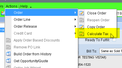

And what if you process “Calculate taxes” on the order, before making the packer?
(its on the Actions menu, under Order -> Calculate Taxes)
Same error message.
Order has one line and the tax on that is zero.
Of course the tax is zero. It hasn’t been calculated yet. :wink:
