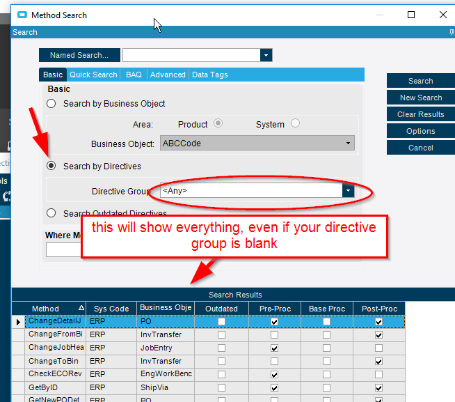

do have a customization on the screen at all? Do you have any method directive BPMs? or and DataDirective BPMs? These are the three places where that could show up.
I don’t see any customization on the form, nor have I been able to find a related BPM or DD. I’ll keep digging…
you should be able to see all of the BPM’s in the search. Just set it to < any > on the directive group. It will be in that list. Same idea for both method and data directives.
Thanks. I’ve looked over the list and haven’t been able to find anything related to this. I’ll keep digging.
