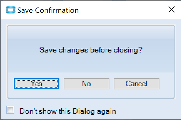

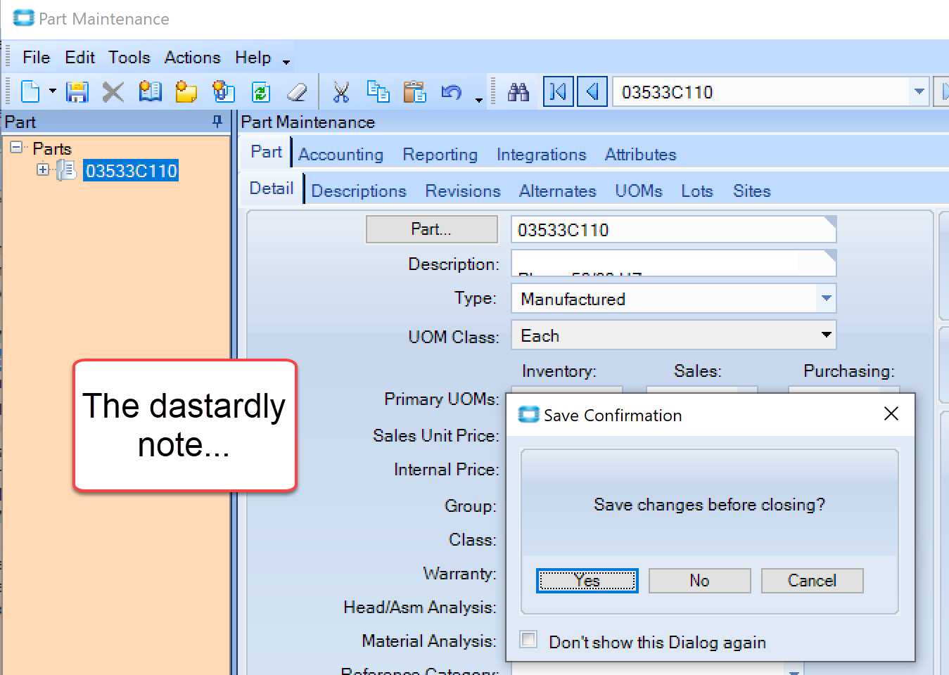

The means by which the change occurs is on exit from the form after change of price and after save (per screenshot), it asks if you want to save changes… despite the fact that I didn’t do any change after the Sales Unit Price change.

In further testing, I have found that it doesn’t matter if the Part is setup on main detail page as P or M. I need two sites and the first one in the list needs to be the transfer one. Then a change in Sales Unit Price, and subsequent save, causes the first site to get its sourcetype changed to agree with the Part detail when user exits out of Part Entry and it unexpectedly asks user if they want to save changes… this is despite having saved the sales unit price change already.
The unexpected extra dialog looks like this: image

I can confirm this is a bug just based on the code, I wasn’t able to fully duplicate it since it is fixed in the latest 10.1.600 version, and latest 10.1.500 doesn’t trigger the “Confirm changes” message on exit.
Basically if the part has 2 or more Plants, any change will update the PartPlant record of the current Plant(not necessarily the first one or the one setup as Transfer) and it copies the type among a few other properties from Part to PartPlant.
The workaround is to simply click No on the confirmation message, the unit price change is already saved, what you are confirming are most likely the PartPlant changes.
If you contact support refer to SCR 194798
