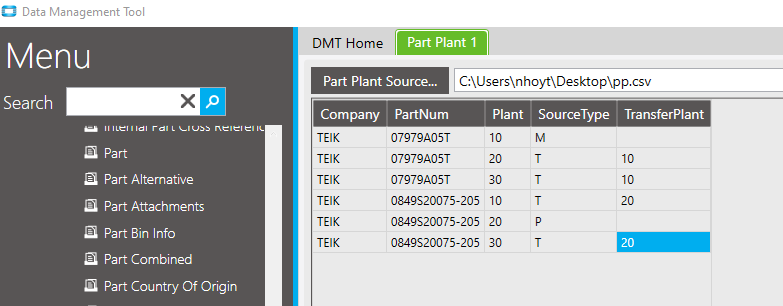

I ran a test. I did a change on a mfrd part to be M in different plant (was 20 now 10) and switched up the transfer plant to be from 10. Also, I did a change on a purch part to (was p to 10, now p to 20) and switched up the transfer plant to be from 20. Both worked without error. I was curious if your problem might’ve had to do with not having a method for the mfrd part in the plant you were changing to manufacture from, but we have this and didn’t get an error.
Here’s my data example, run with update only (not on new records):

Thank you so much for testing. This has been frustrating!
Some of the new revisions don’t have their method completed, true. But… the failure’s happen with purchased parts too, so I didn’t look deeply at the revision issue. I’ll test that line better.
One thing I noticed is your version is 10.1.600.2, we’re at 11.2.200 and cloud.
And I know I’ve been making partplant updates with DMT since Vtg. 8, so maybe new version has a bug?
