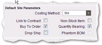

I’m surprised that you can enable Qty Bearing AND Buy To Order on a Part.
Would a part that is Qty Bearing and BTO (and purchased as BTO) increase QOH upon receipt? Or is the just the cost tracked for BTO items (like if it was BTO for an On-The-Fly Part)?

Note that in a Multi-Site environment, the screenshot you took was from the Part front page… this is the DEFAULT for all new sites added.
So, you can set the DEFAULT to be BTO and Qty Bearing. but then in individual sites, it might be Non-BTO.

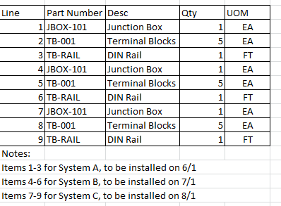

Another issue is when the SO is entered but the item appears on multiple lines (the SO is laid out to group parts for particular phases together). For example:
If all three parts are BTO (and are not in the Part Master), We have the following issues:
  • This requires 9 PO lines.
  • If part TB-001 is sold in boxes of 10, we’d have to buy 30, when we only need 15.
  • Part TB-RAIL is sold in 3 FT lengths. We’d need to buy 3 of them, cut off (and throw away) 2 FT of each.
