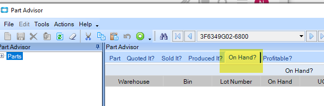

Also, I believe that Part Advisor worked for the on the fly part and would show on hand, highlighted tab screenshot. I think you can ship it if manually type in the part number and use the bin where it was received to.

I don’t have access to E9 anymore, but it sure did have BTO on the order release. It looked very much the same as E10’s order release. I believe user could enter the order num / line on customer shipment… not completely positive. However, I recall they had to ship from the bin that they received that OTF part to. It was like the system couldn’t count it unless you told it exactly where it was. I recall being surprised when a non-super user showed me that they saw the part in Part Advisor, when it couldn’t be found in system. It was one of those I’ll be darned moments :joy:

I think that the Part Advisor showed where the part was… if I’m not mistaken.
