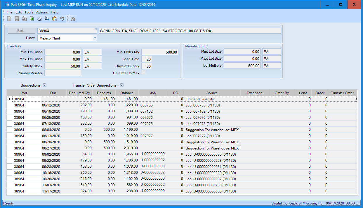

We are starting to use PO Suggestions and had our Purchasing Team work to set up all the proper MOQs, Multiples, Safety Stock, etc… We are seeing that PO Suggestion is giving the correct quantities but it is always trying to bring in Parts before they are actually needed. Below is an example of Time Phased with the Suggestions on and the off. Any ideas of where we can start to look for incorrect settings? Thank you!
Does the demand for the item properly reflect your plan to supply the item? Do you have unmet demand inside the item’s lead time? What does the schedule look like for the parent item? The suggestions will line up with the plan for the parent that is needed to meet demand. “Early” is relative. Early to what?
Hello Gil and thank you for the quick reply. Based on the second screenshot that shows Time Phase with the Suggestions flag unchecked, we see that we don’t start going negative until the Job that starts on 10/16/20 for this particular part. So based on the Lead Time that we have specified and some of the other parameters we would expect a PO Suggestion that would bring the Part in a few days before 10/16/20. However the PO Suggestion that is given brings the Parts in on 8/04/20 (2 months before it is actually needed).

I notice there are three separate demands for Job U-00000000002. Qtys of 179, 360, and 540.
Is the part used in different sub-assemblies, and at different levels?

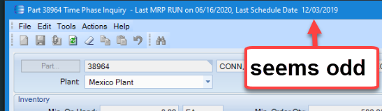

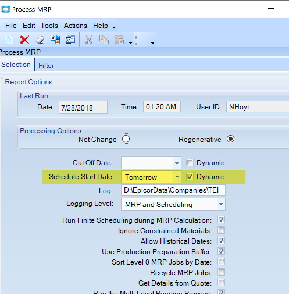

Hi Sal,
Your Last Schedule date, per below concerns me. I think you should try and run it with a dynamic date and see how your results come out from that.
Nancy
Hi Nancy,
Thanks for the suggestion. I’ll try that today and see what happens!
Sal
