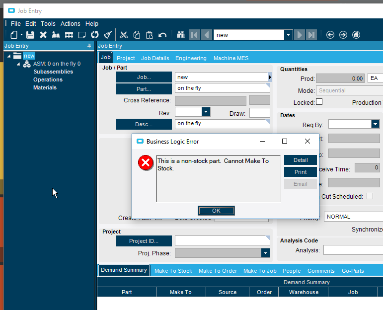

Is there a good reason that I am not aware of why it would be preferable to create a job using a part on the fly? Many of our jobs are created to build a part on the fly. This creates an issue when receiving a completed assembly on a job to inventory where upon scanning the job# on the traveler Epicor just hourglasses and eventually crashes.

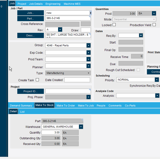

At any rate I found an answer as to why the entry persons are using Part on the Fly: because their instructions say so. I am changing the instructions so the Jobs are for actual parts. I am wondering now what DMTâing the top level part to a real part will do to the hundreds of jobs that are already out there; any words of wisdom? Or would it be better to put the change in for new jobs and let the older ones work their way through the system?
You shouldnât be able to receive on the fly parts to inventory, or make a demand link to inventory. Something is fishy here. Are you sure your arenât receiving from job to job? Or something else?

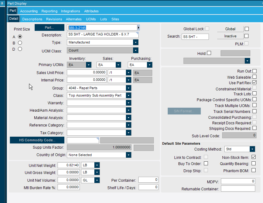

To add on to @Banderson comments, the Part must also be âQty Bearingâ of its job to be make to Stock.

If a Qty Bearing part is a component of a BOM or Job, and then that component is changed to non-Qty Bearing, a Mass Issue will create part transactions and drive the QOH negative. (The QOH of that part had to be zero, from when it was changed to non-Qty Bearing)
Itâs intended, it has to do with costing/accounting. You can make non-quantity bearing parts, and you can issue them. There is never an inventory quantity, but the dollars can go in and out of the GL. Sometimes itâs not worth keeping a count of certain item.
