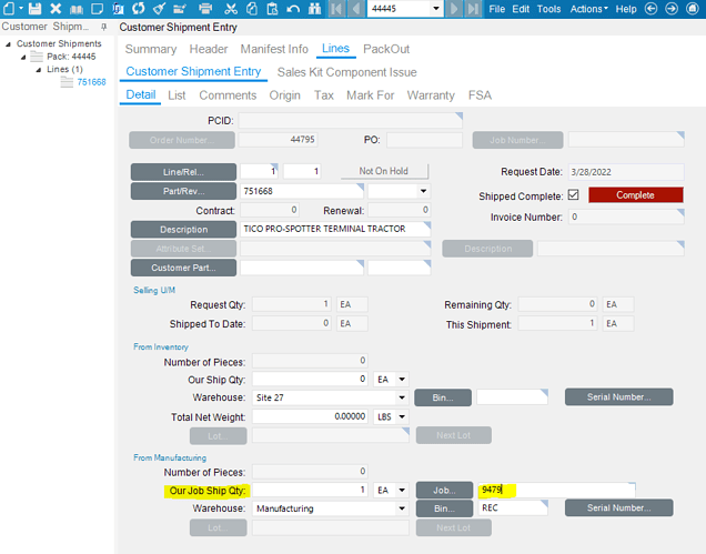

It should appear in customer shipment entry when you enter the line. Here is an example of make direct (thought not POTF). All I did was enter the order number, line, and release.
What is going to be new for you is that Our Ship Qty will be zero - that’s good and DO NOT change it - but Our Job Ship Qty has a number in it, and next to that, you should see the job number pop in automatically.
And then invoice as a normal shipment.
