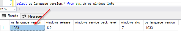

Do you have access to SQL Management Studio? If so, you can determine exactly which terms are searchable via this search.
The full text parser isn’t always intuitive.
  1. Open SSMS, and run the following to get your locale identifier.
    select os_language_version,* from sys.dm_os_windows_info
    For me, it’s 1033

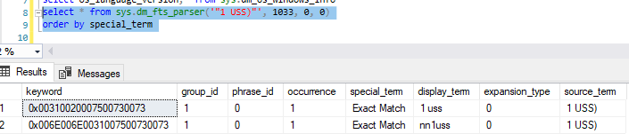

  2. Run the following against the database that has one of those descriptions
    select * from sys.dm_fts_parser('"Washer, Flat, 5/8, SS304, 0.6875 Id X 1.50 Od X 0.078 Thk Min"', 1033, 0, 0)
    where
  • you paste in the part description between the double quotes (1 in the screenshot),
  • replace the locale identifier from the first query (2 in the screenshot),
  • which the terms that you can use within the application where the special_term is Exact Match with the term being in display_term (3 in the screenshot)
  • anything listed as a noise word (4 in the screenshot) is not searchable as SQL is treating them as common/noise.

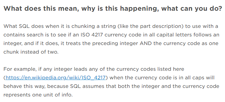

If there is a currency code that is part of the ISO 4217 standard SQL has special rules about it.
Based on this test, that is what is happening with USS
From that Wikipedia article:
There is a write up I did on a different code (BRE), with some suggestions on how to work around this.
