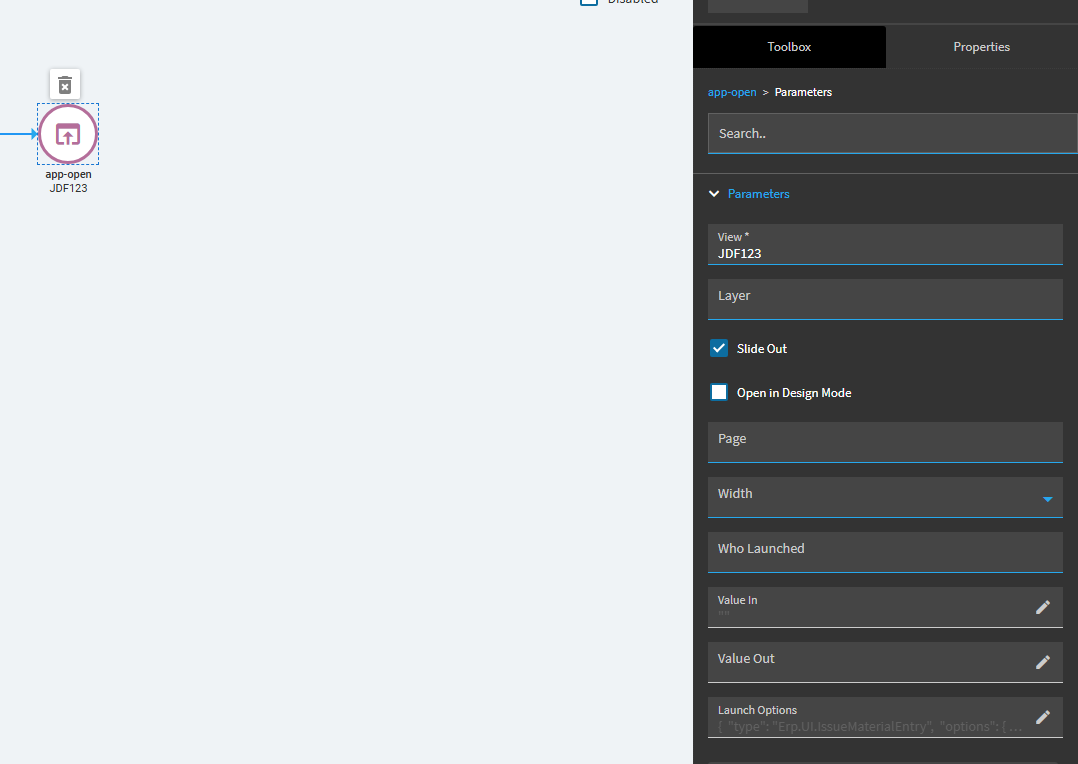

So I’m so perplexed here. I’m trying to open a slideout that opens Issue Material and populates with the current selected job and mtl seq etc. I’m able to get it to open with the right job if I just pass that but I need to be able to pass Job Num, PartNum, AssemblySeq, MtlSeq. I’m assuming my syntax is just wrong but struggling to find the right syntax here. This is my current:
{ "type": "Erp.UI.IssueMaterialEntry",
"options": { "valueIn": [
{ "JobNum": "{BackFlushExceptions.JobMtl_JobNum}" },
{ "PartNum": "{BackFlushExceptions.JobMtl_PartNum}" },
{ "AssemblySeq": "{BackFlushExceptions.JobMtl_AssemblySeq}" },
{ "MtlSeq": "{BackFlushExceptions.JobMtl_MtlSeq}" }
I’ve tried SOOO many different options..
