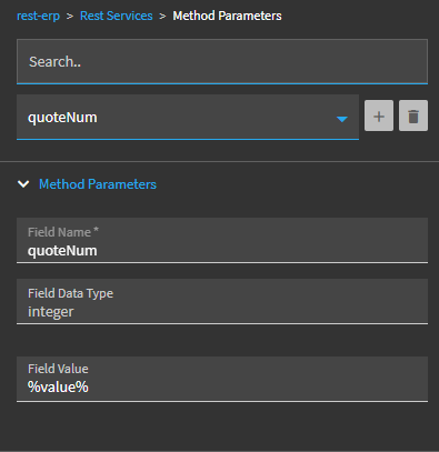

I was able to mostly get this working to open the opportunity/quote entry page from a dashboard, but I get an error from the CheckQuoteNum service. The method parameters in the rest-erp event are below, I can’t seem to find/figure out how to pass my quotenum from the dashboard into this field when opening from the dashboard and ignore when I’m opening directly from the opportunity/quote landing page. Can anyone help me find how this call is getting %value% set?
This is a variable you get to use when you have a column changing event.
It will be what the column is changed to. I wouldn’t recommend using that here. Assuming your dashboard grid is bound to a dataview named MyQuoteBAQData (or whatever), then you would use {MyQuoteBAQData.QuoteNum} to send the quote of the line that’s currently selected in your grid.
Use a condition widget to check the value of the field; if it’s empty, then you can assume it’s from the landing page.

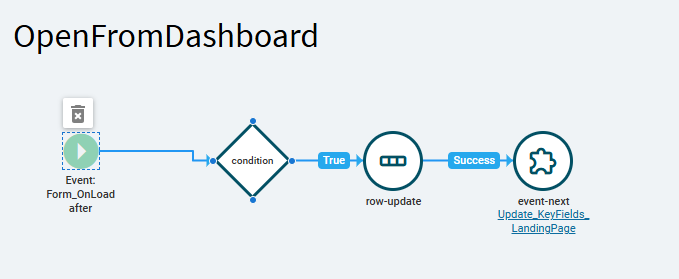

@hmwillett Here’s a more detailed picture of what I’m doing. The event on the dashboard to send the quotenum looks like it’s working correctly. On the opportunity/quote page I have this event to receive the quotenum.
The condition has the horribly ugly string context && context.initialValueIn && context.initialValueIn.ValueIn which seems to be working correctly in that it fires when I load from the dashboard and not when I’m using the Quote landing page.

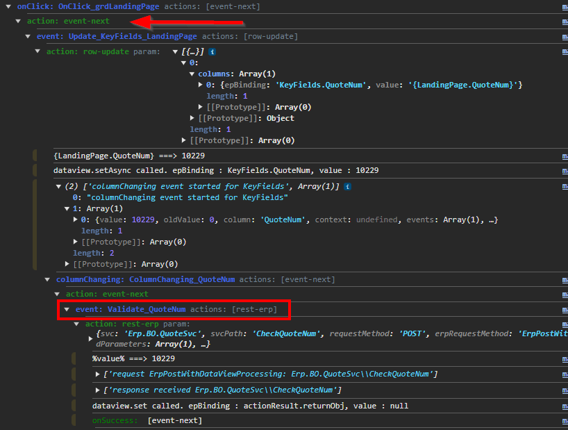

I’m trying to mimic/hijack this sequence of events starting at the arrow, but I’m getting an error with the event in the red box.
I have my row update setting LandingPage.QuoteNum to "%session.context.initialValueIn.ValueIn.QuoteNum%" and then I call the Update_KeyFields_LandingPage event which sets KeyFields.QuoteNum to Landingpage.QuoteNum.
From the bit about the %value% being from a row change event I expected the KeyFields.QuoteNum to flow into the CheckQuoteNum call, but I get this error. (the summary tab is blank)
After I click ok on the error the quote loads correctly, but I can’t really push something out to users with the instruction to just ignore that error. :man_shrugging:
