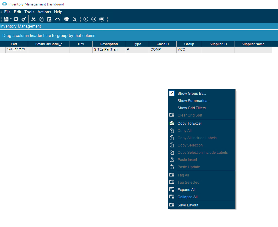

I don’t see the “Uptake from excel”. I also can’t seem to get paste update to show up on this dashboard. Does this depend on how the BAQ is written? I’ve noticed if I only have one table on the query I have paste update/insert.
I can’t see the uptake from excel button on my Epicor instance as well. I could see it earlier. Not sure what happened there. I deployed this as a dashboard Runtime & dashboard assembly both but no luck. Anything gives?
