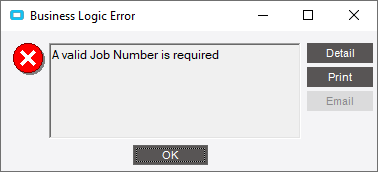

I am trying to streamline entry of Time and Expense for our Service engineers, however,I get the following error
sheet attached

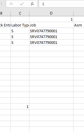

After looking at the attached excel files, I can immediately see the problem. You have some rogue data
Dear @AVWebb,
I have checked the attached file and identified that ASM (Job Assembly) column value is missing. Could you please enter the value and try to upload.
