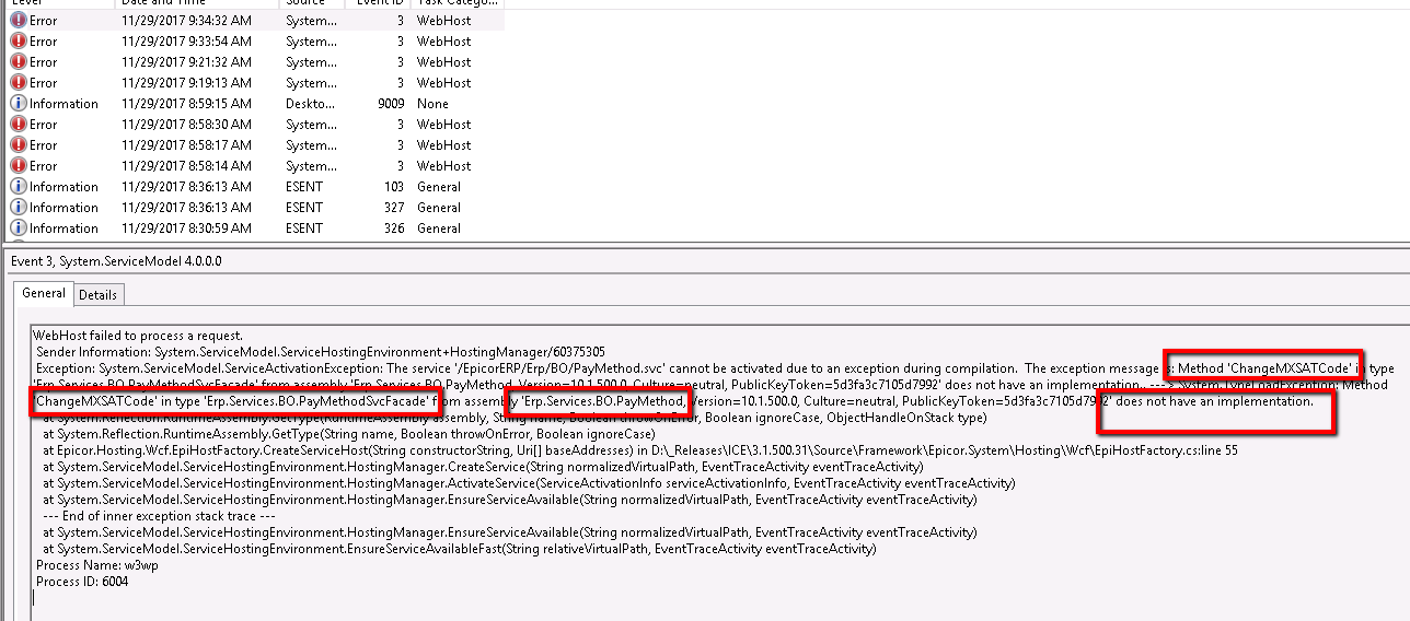

We have recently updated from 10.1.500.27 to 10.1.500.31 and now the Pay Method Entry Screen yields an error, which I believe is being caused due to the recent Mexico SAT CSF Functionality added to Epicor.
However, we do not use any CSF Functionality.

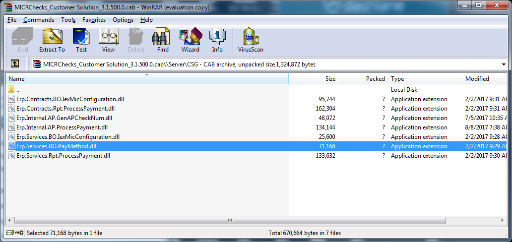

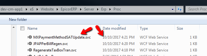

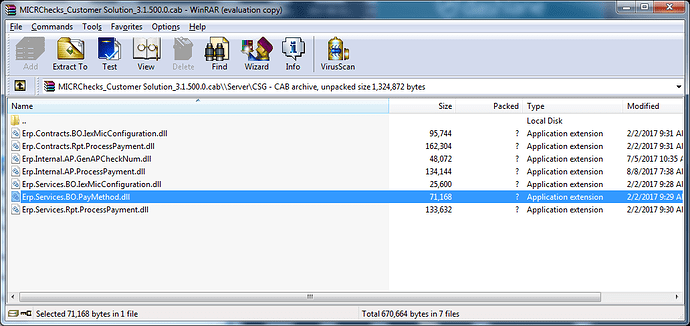

I think here is what is going on MICR Checks installs the following in the /CSG Folder and therefore Epicor is using this dll first… and this DLL is from 2/2/2017 yet the one in Assemblies is 10/10… So I think the folks at IEx need to update their MICR CSG Package dll (Erp.Services.BO.PayMethod)
Sounds correct? I can make the problem go away by removing the that DLL from CSG, but then I probably have broken the MICR Extension.
