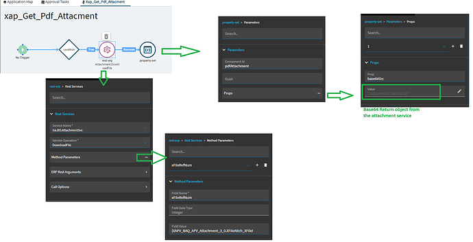

Although the SRC and base64Src property are not visible on the erp-pdf-viewer in design mode or even in debugger setting the base64Src property with the return object of the Attachment.Download method (provided it was a pdf attachment) actually works and the pdf is displayed:

Thank you for this! How’d you manage to figure out the base64Src property without debugger?
