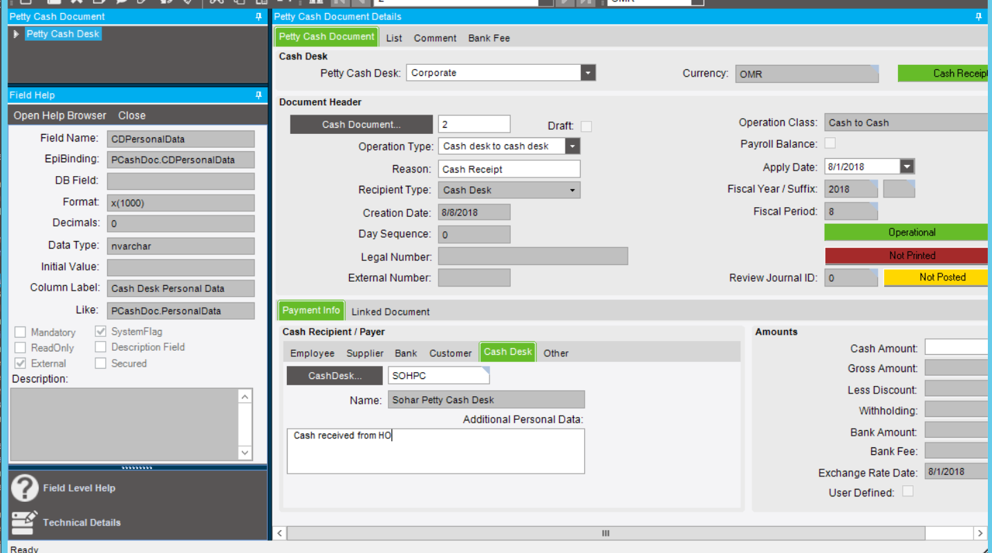

Hi everyone, when we are trying to update the “Personal Data” (refer to attached screen). It is not updating.

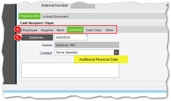

Your screen shot is missing the “Additional Personal Data:” label (see pict from Users Guide below). Is it possible the text field is not the original, and/or it’s not bound to the DB field?

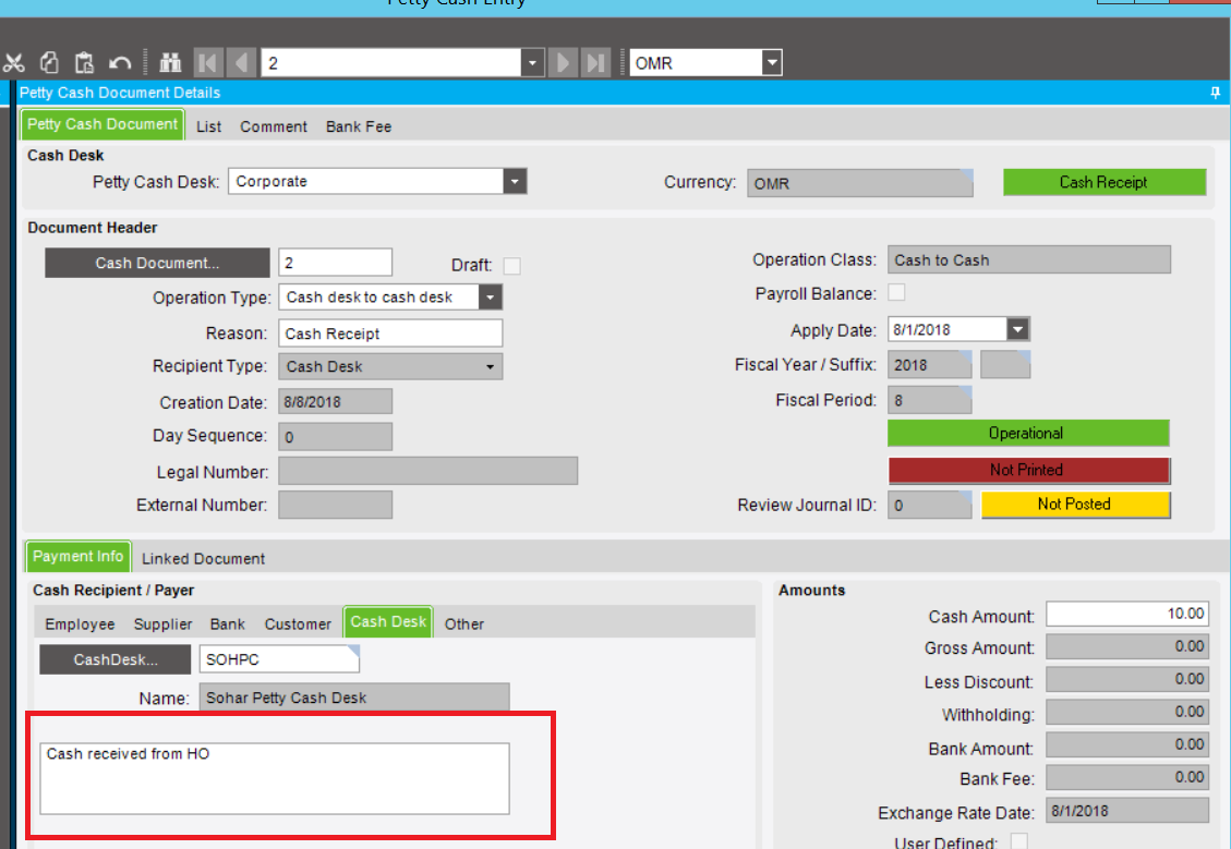

“Additional Personal Data:” label is showing now (refer to below screen)
Is it possible the text field is not the original, and/or it’s not bound to the DB field? (refer to below screen)

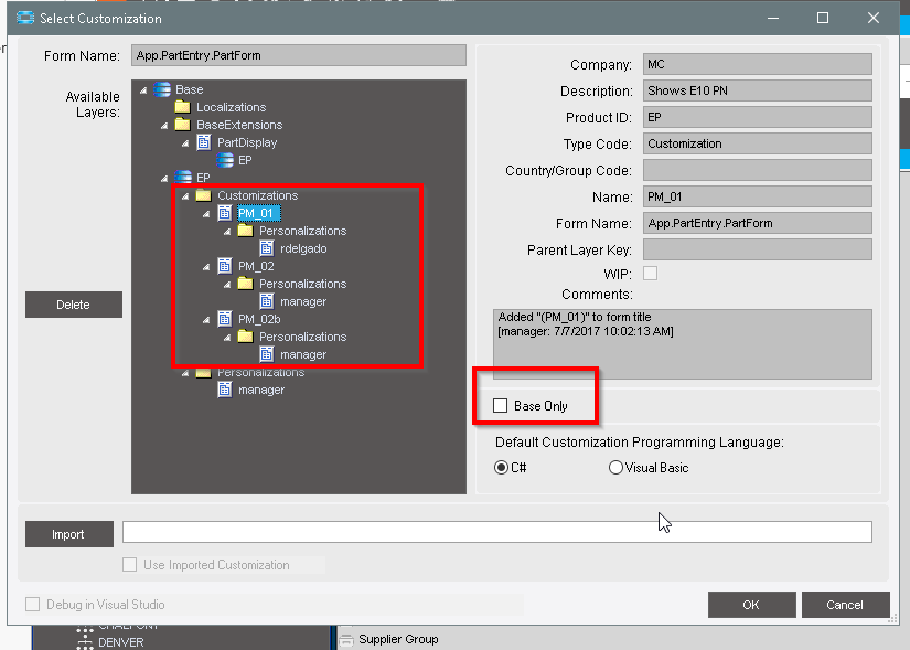

You can make sure it’s not a customization by enableing developer mode and launching the program. Then select Base Only. For example, with Dev Mode enabled and I launch Part Entry, I see:
I can select one of those customizations to load the form with those customizations. If I check the Base Only box and click OK, I get the “base” (no-customizations) form.
If the problem doesn’t exist in the base form, then its a customization causing the problem.
The fact that the “DB Field” is blank in the Field Help, shows that it is not pulled directly from the DB, but rather a “view”. Specifically, the PCashDoc view. This is usually done when the UI form needs to combine data from different tables.
This is odd because there actually is a table named PCashDoc.
I just searched the Epicor site for PCashDoc, and found that appears to be new in E10. So maybe you’ve found a bug.
I’d contact epicor about this. Point out that this entry uses a different currency (assuming that OMR, isn’t the default for your company).
