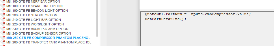

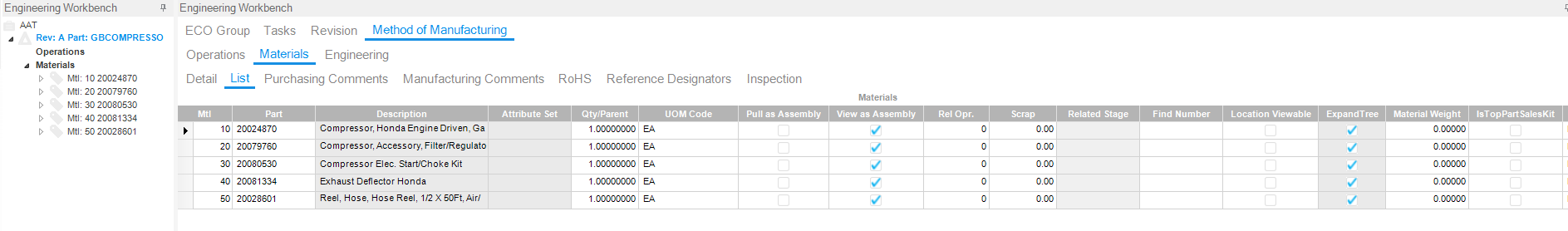

I have a phantom in my Config MOM, that isn’t pulling the materials when I “Get details”. As u can see, I have the “SetPartDefualts” in place.
I also have the phantom engineered correctly(I thiink).
Here’s the MOM after I configure.

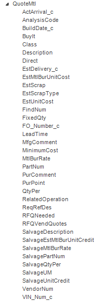

I struggled with this too. Could it be that you need your rules for QuoteAsm.PartNum instead of what you have, QuoteMtl.PartNum?

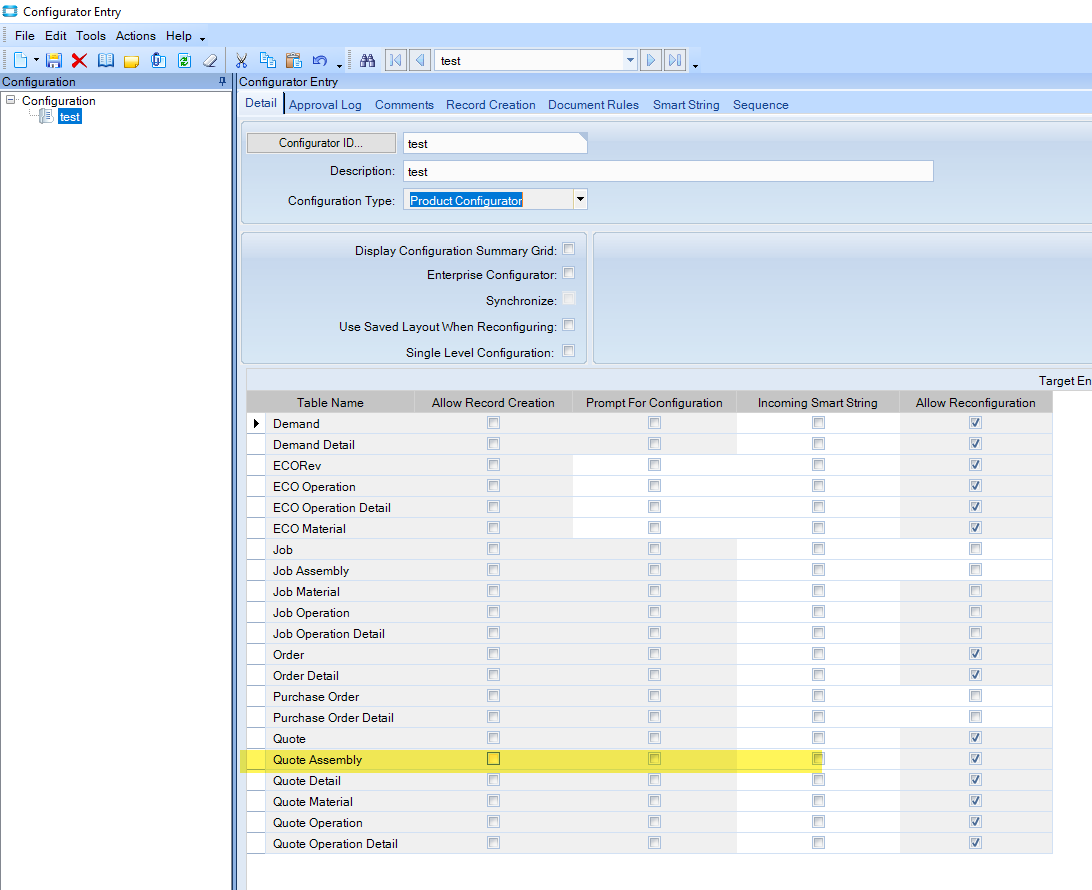

QuoteAsm is not an option in my Target entities.

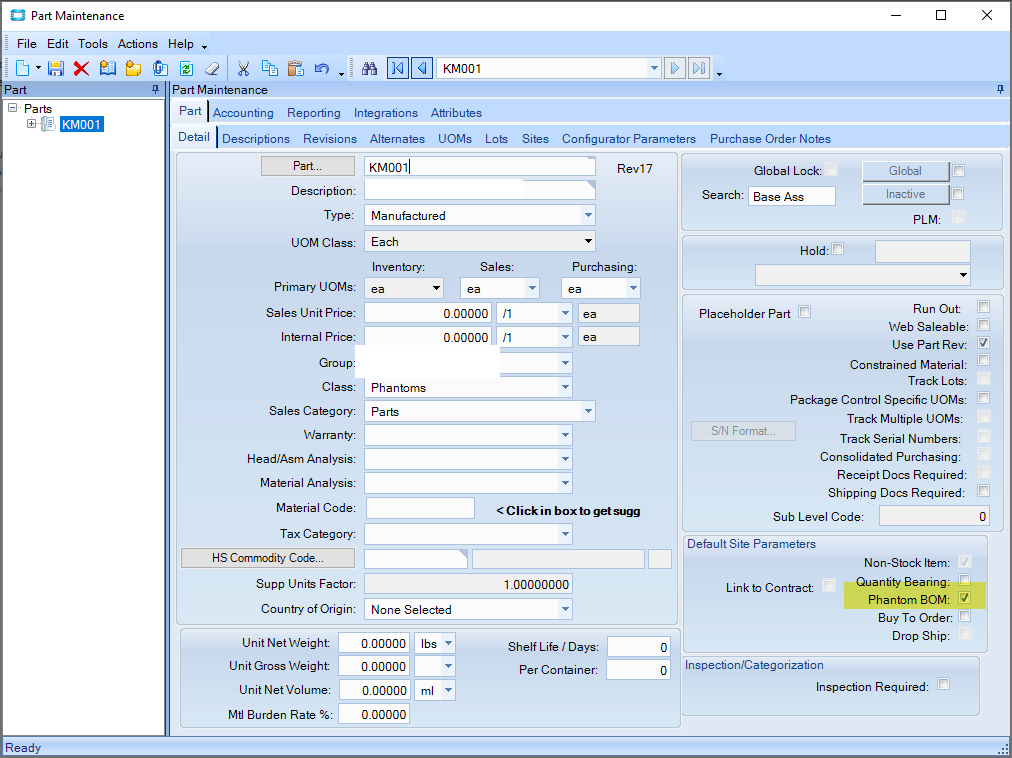

Hi Anthony,

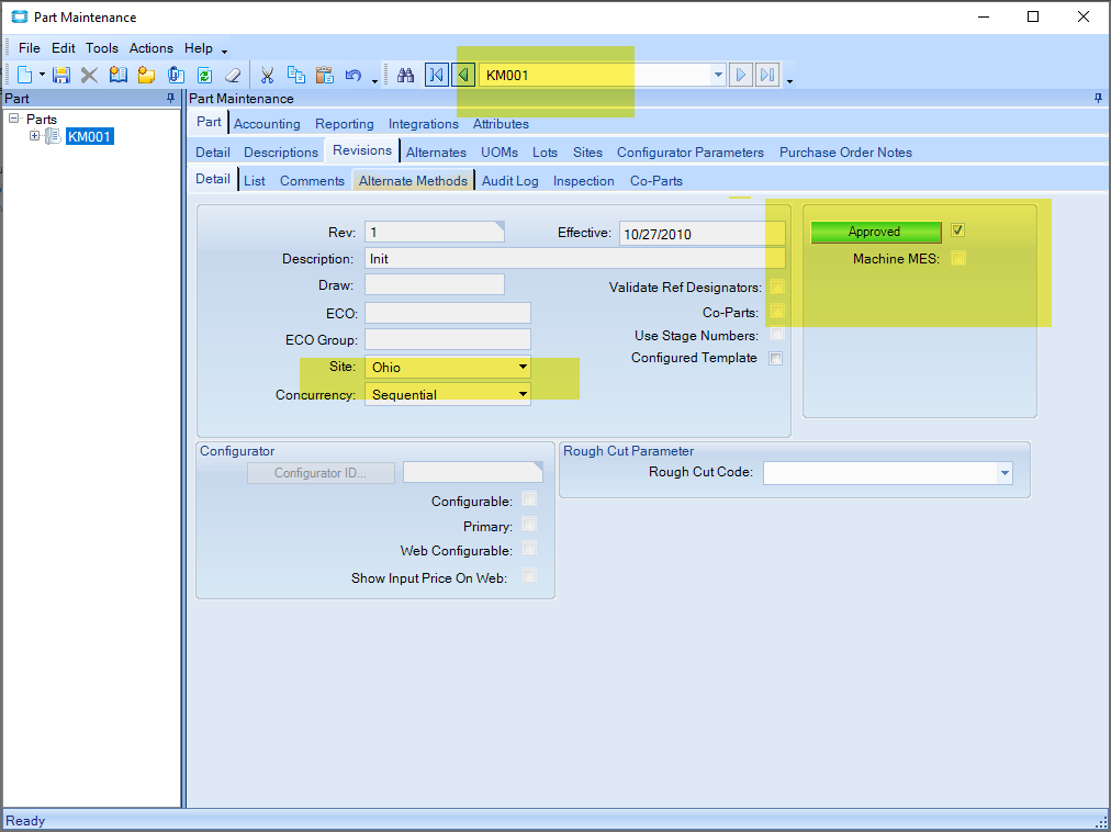

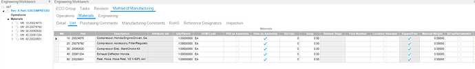

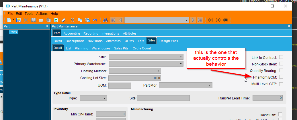

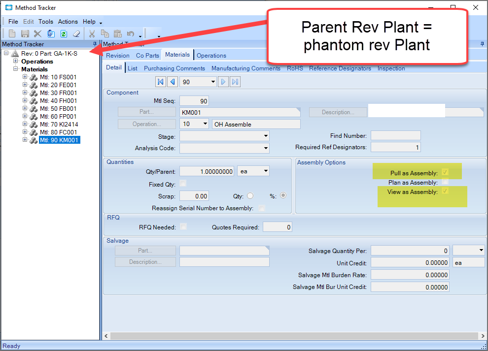

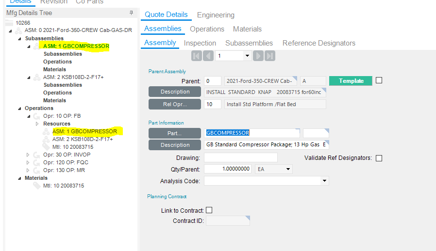

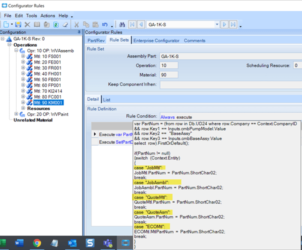

Can you select it for allow record creation on the Configurator Entry / Detail tab per below? We do not have it on quotes because we just configure at sales order line level, so that uses Job Assembly for the phantoms. I used a case select to make it work regardless of the setup also, like screenshot 2, since we had some phantoms some not. Finally, see screenshots 3,4,5 for our KM001 part setup. The phantom needs to have the same Rev Plant as the parent, I believe, for it to work.

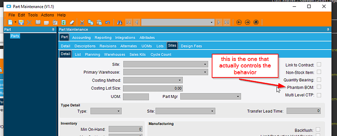

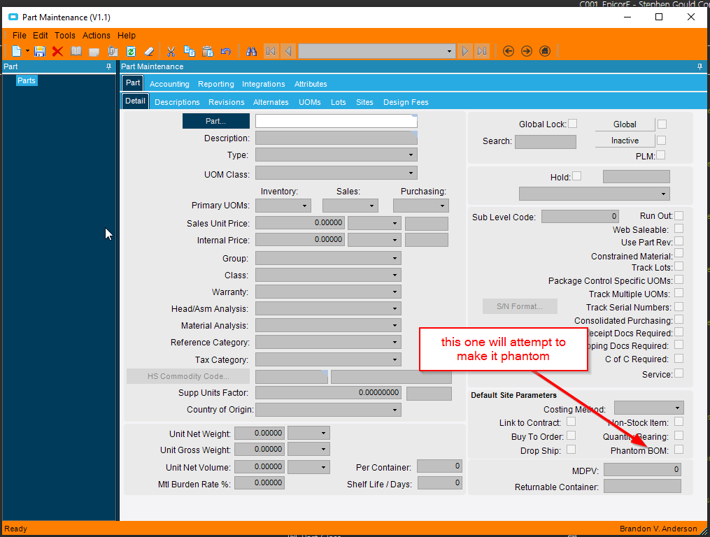

I’m assuming that you looked a the plant record for the phantom checkbox? The one on the detail screen attempts to change them all, but ultimately, it’s the sites tab one that controls it, because they can be different per site.

First the cause: If the phantom part has the same Revision as your placeholder, it pulls in “correctly”. If on the other hand, it is different, it will not expand into its components. I tried many combinations and could never get a material record to properly expand.
To resolve, I had to specifically have place holders that were marked as pull as assembly. Then in your rules, you set all your assembly variables and use the function, SetCurrentRevision(), instead of the SetPartDefaults() that you would use on a material record.
