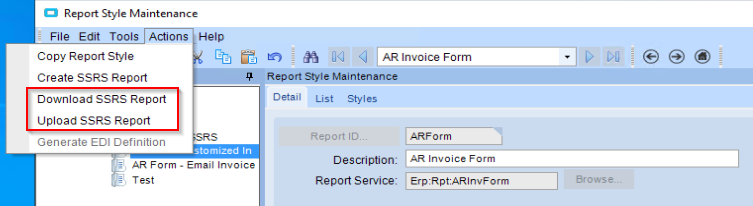

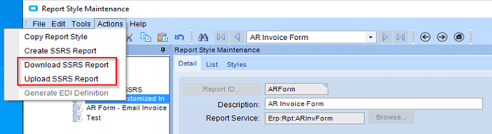

Here’s a quick thing you can do to get reports (the RDL files) from one instance to another:
Go into Report Style Maintenance, open then form, select a style, and select Actions-Download to download it to your local PC:
Note that if you download to your Documents folder, Epicor will install a “reports” folder there and download your report files to the appropriate sub folder.
You can go to Microsoft and download a copy of Report Builder. Then you can open the report files and look at them. You won’t have access to the server for the connection, but that’s okay to look and edit. You just can’t run them from there.
To upload edited files to your current Epicor instance, go back to the Report Style Maintenance and take the Actions-Upload option. If you selected the Documents folder, just select that at this time for the upload. Epicor will know where the file is.
To upload reports to a different instance, like Test, just open that instance, go to Report Style, select the style, and Actions-Upload. That will fix the data sources.
This is a one-report-style-at-a-time fix, but if you’re looking at one report, this is a quick way to get it to the other instance.
