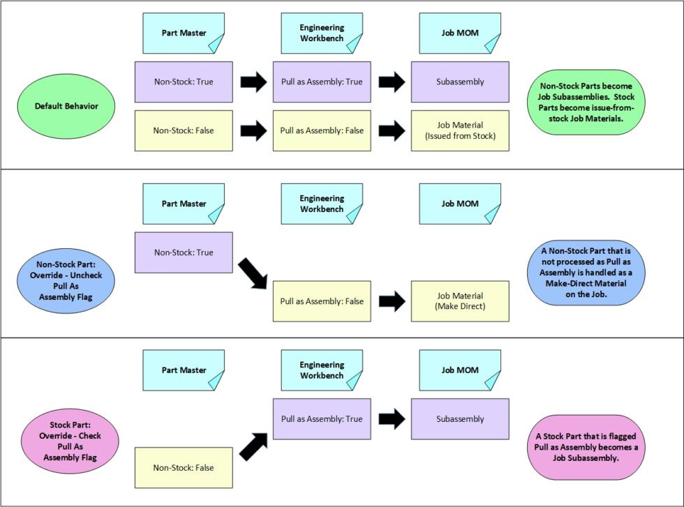

Below is a good video of a decent explanation further diving into the picture. Quite a bit of good information.
If Non-Stock item, Pull as Assembly is defaulted when creating MOM. As said in previous Plan as Assembly created a demand linked job.
https://www.youtube.com/watch?v=yptYu0ChugE

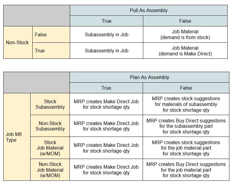

Based on that image from the video, I summarized it in the top table. Then, I’m trying to understand Plan as Assembly also, so the bottom table is my attempt at that. How do these look to y’all?
I’m really unsure on the Plan as Assembly, as both the field help and the MRP Tech Ref are not entirely clear.
If part is not set Pull as Assembly using Plan as Assembly is not allowed. At least that what the help field says. In practice it just acts as a normal material.
As far as the rest we don’t have anything set to Plan as Assembly and it always has Make Direct checked. From what I gather if Plan as Assm is checked true, it can create seperate jobs from that. Im not sure if it looks into inventory on hand.
Point of clarification: having NEITHER box checked makes it act like a normal material. Valid states are: neither checked, Pull As Assembly, Plan as Assembly. As far as Pull vs Plan as Assembly, when you check one, it will uncheck the other. You can’t have both. It’s one or the other or neither.
