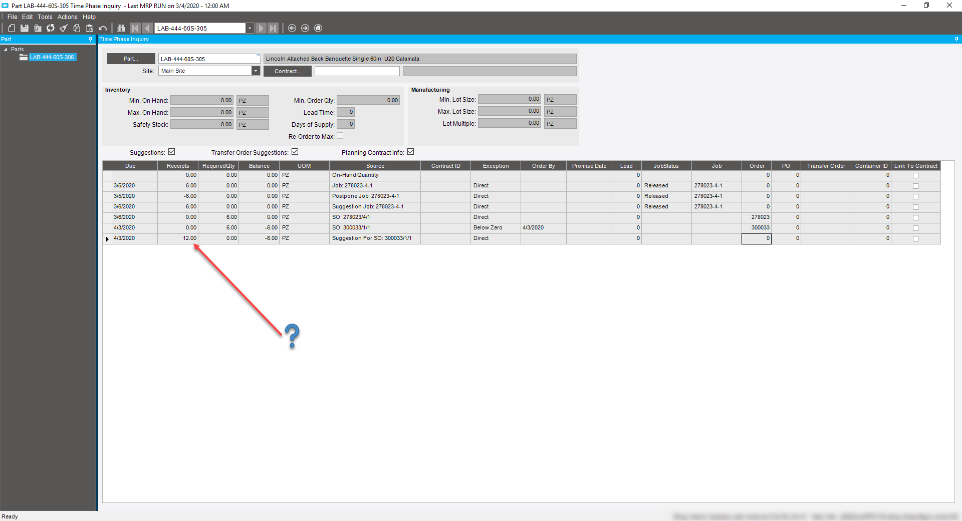

One issue I’ve come across, however, is it seems that all of the new job suggestions in the planning workbench for a specific customer only suggests creating the job for double what the release is for.
The line (and release–there’s only 1 release) is for 200 “PZ” (that’s pizza), yet the planning workbench is like, dude–you need 400. Now, it’s possible that our planning engine is just high and wants more pizza, but probably not.
Any idea what would be causing this?
The UOM is PZ across the board, so there’s no UOM conversion going on.
There’s only a single release for 200, so it shouldn’t be trying to combine things.
I have confirmed the users aren’t just changing the release after the suggestion was generated.
This is for version 10.2.200.11.
