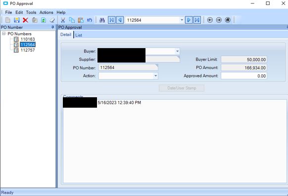

Is there a way to see the revisions made to the purchase order in the PO Approval screen without having to go to Purchase order tracker? Thanks in advance!

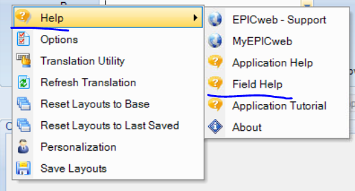

Turn on field help and technical details should show you where the data is so you could make a baq.
Do you have a screenshot of what you expect me to see? What is BAQ?

field help with right click.

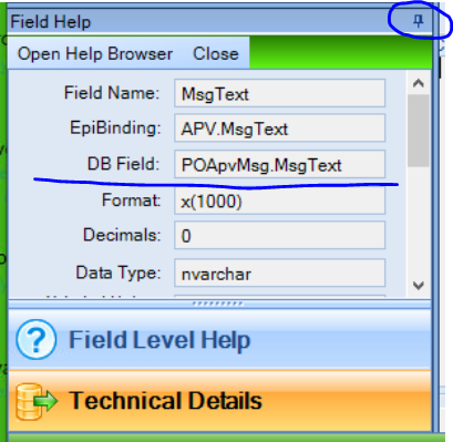

Click the pin to hold it open then click field and technical details to show the information.
