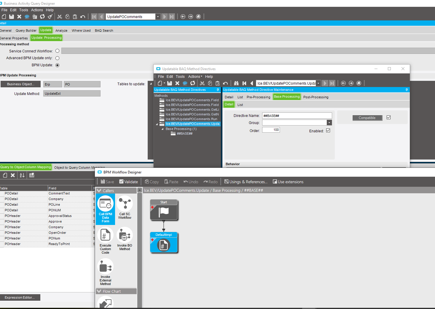

You can use an updateable dashboard. The UBAQ looks something like this - just added widgets to BASE - to handle unapproving and approving. The user just modifies the CommentText field when editing. You could do the same with DMT if you wanted. Most the requests I do for this use a dashboard for this with this type of UBAQ behind it.

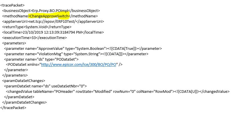

Hi @danbedwards,
have you actually done it and worked for you ?, because i have tried this idea and could not bypass the approve flag at all, even with invoking the changeApproveflag method
Yes - works great.
any chance to share your uBAQ ?
Absolutely. This is 10.2.300 but I have similar back to 10.1.400 and up to 10.2.400.
UpdatePOComments.baq (51.6 KB)
thanks, but can not see your modified advanced BPM workflow

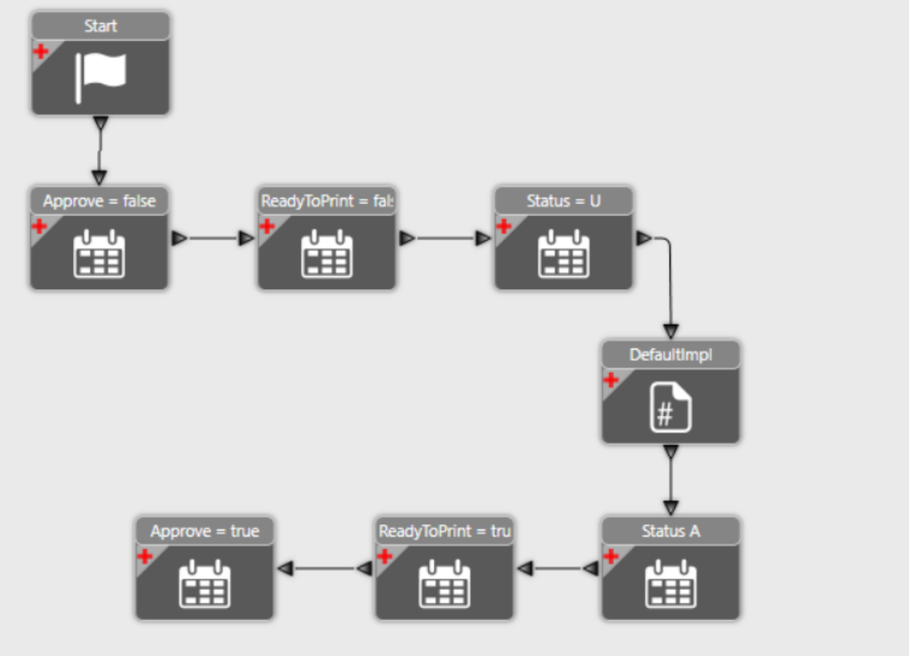

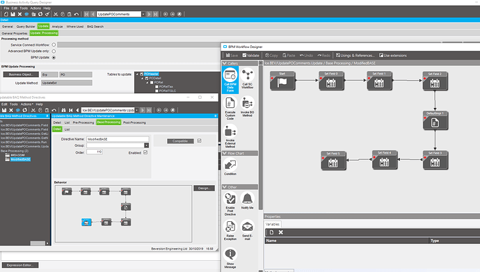

Because I modify the base the custom logic does drop on import sometimes. There is a way around this. For now, you can add Set Field widget and do the following with 3 on each side of the Base.
Before Base
1 - Set Approve = false
2 - Set ApprovalStatus = “U”
3 - Set ReadyToPrint = false
After Base
Do the opposite of above.
this work beautifully, many thanks mate, really appreciate your valuable tips pal, it is priceless

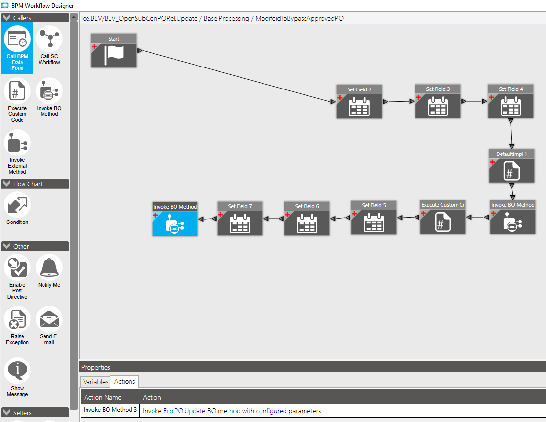

Hi @danbedwards
just noticed that PO does not re approved after this update, any idea ?
Is the user running the update-able dashboard setup as a buyer with an unlimited limit? If not then the controls to prevent someone from approving a PO that exceeds their buying limt, may be working against you.
Use this - there are two flavors of this multiple rows and single row. This is the single row and for multiple you put the code inline in the default widget.POUpdate.pdf (842.5 KB)
thanks for your feedback @ckrusen, i agree, but i am trying to update my PO and i have no limit restrictions, beside i would expect the exception message to say that, if it is the case.
Hi @danbedwards,
appreciate your support mate, your technical document is crystal clear and i have done it exactly as per your design, but still no luck
