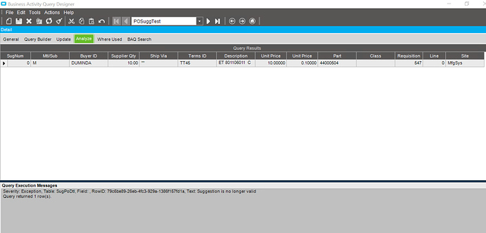

Hi timshuwy
I tried it from UBAQ. Result is same. Is it related to in adequate data to create PO Suggetion?
Hi Louis
