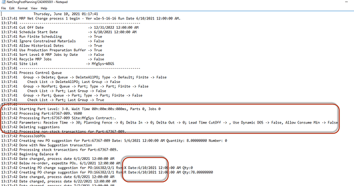

@Craig If you have the PO suggestion logs look thru them to get what parameters Epicor is using for this part. If you are not logging then I would suggest turning that on. You can also run a small run of parts in net change manually and look at the log. Planning time fence or in out deltas could be the reason the date is not getting changed.
Below is a sample from a log.
Greg
Thanks Greg. I looked at the planning settings yesterday but tested again just now to be sure. Ran a Net change suggestions to get a base line then checked the log, then took the planning settings off on the part and the part class and ran net change suggestions again.
No change.
Still trying to bring the part in on 6/10
@Craig We don’t use receive time, so I don’t really know how it changes the dates, but 30 days may be causing an issue. Can you test with that off?
Greg

You will never get a suggestion to move a PO to earlier than the current day, even with historical suggestions enabled. If you have dates in the past, Epicor considers those items to have occurred per the dates shown. If you want dates in the past, you have to enable historical dates on the MRP run.
That being said, I have no idea why anyone would want to do that. You would end up with suggestions that cannot be achieved.
I think @BScanlan nailed this, right? You have the scheduled start date set for “today” so that’s the limit.
The log even looks like it calculated that the PO should be for May 6, but then it thought, well, you said you don’t want it any earlier than today, so June 10 it is.

My cutoff is “today” (June 10 at the time), but there are a whopping 3 suggestions for me before June 10.
Here is one (I deleted excess info). Beats me as to why it got scheduled for the 7th when everything else is 6/10 or later.

Is there a “receive time” established for the item?
yes 30 day receive time.
That should bring the part in earlier. I have ran a test of PO suggestions with and with out a value in the Receive time.
It will also change the purchasing suggestion from today to 30 days in the past. At least in the cases I’ve seen.
