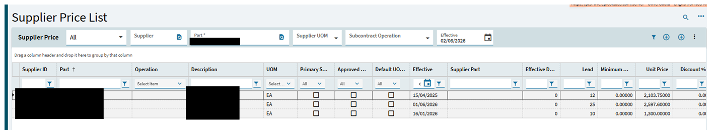

PO Suggestions from Supplier Price List....I can't see why
Which of the 3 options would you expect PO Suggestions to select from Supplier Price List:
And if not what, I think, is the obvious one, then what is affecting it?

  • Dates - it should take the latest effective date relative to the date of the PO/Suggestion. So multiples like you show there with no expiry date would be ranked in date order.
  • Approved Supplier - Ben referred to this. My understanding is that if you have a part with no approved suppliers, then it can be purchase from any supplier and therefore all those 3 records rank equally. If you have at least one supplier marked as approved, then any that you wish to purchase from must also be approved.
  • Default for purchasing - there is a flag on the price list record for ā€œdefault for purchasingā€ that can influence the decision making.
In your scenario above if PO suggestions were generated today (11/06/2026) then I’d say it should have picked the 01/06/2026 price list, but if suggestions were ran prior to 01/06/2026 (or indeed when the date that you actually created that price list) then it would have used an earlier price list.

In all 3 of those case I am having to directly manage the Supplier Price List…It really applies NO useful logic of it’s own?
What would you EXPECT it to do? Or, maybe more correctly, what would you hope that it would do?
You are correct that it picked the one from 01/06/2026, but that is actually the least favourable to the Business…It’s the longest LT and highest Price…
