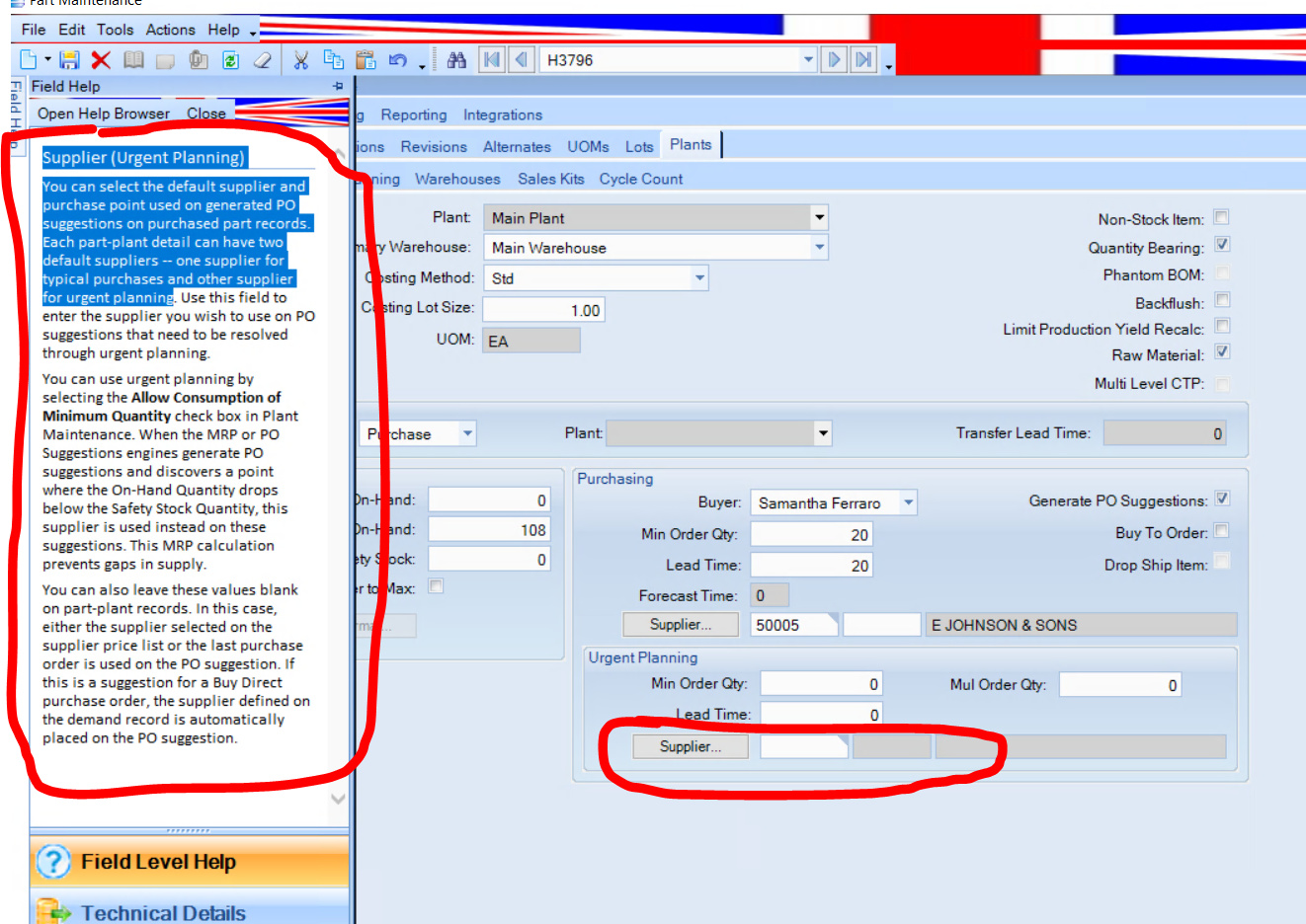

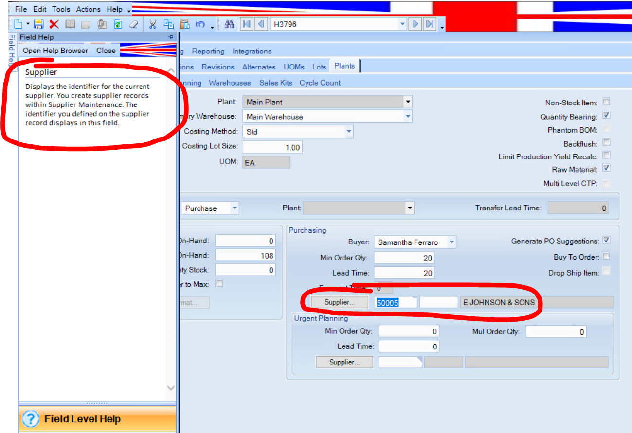

Hi Mark,
We use PO suggestions daily. The supplier comes from the part plant record for the purchasing plant. Also, if urgent planning required, then supplier comes from urgent supplier on part plant.

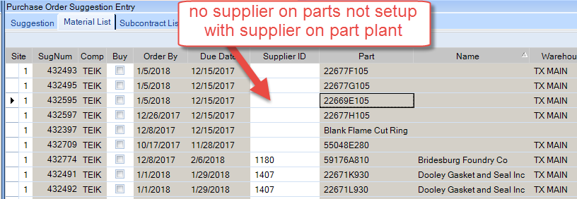

What happens if both supplier fields (purchasing supplier AND urgent planning supplier fields are blank in part plant)?
While Parts will show on the PO suggs screen when some data is lacking, in order to utilize PO SUGGS fully, a part requires:
  1. chk-box gen-PO Suggs is checked
  2. BUYER-ID
  3. Supplier…
Strange that you do not have a supplier identified… and arbitrary suppliers are being aligned to the PO requirement.
Thank you.

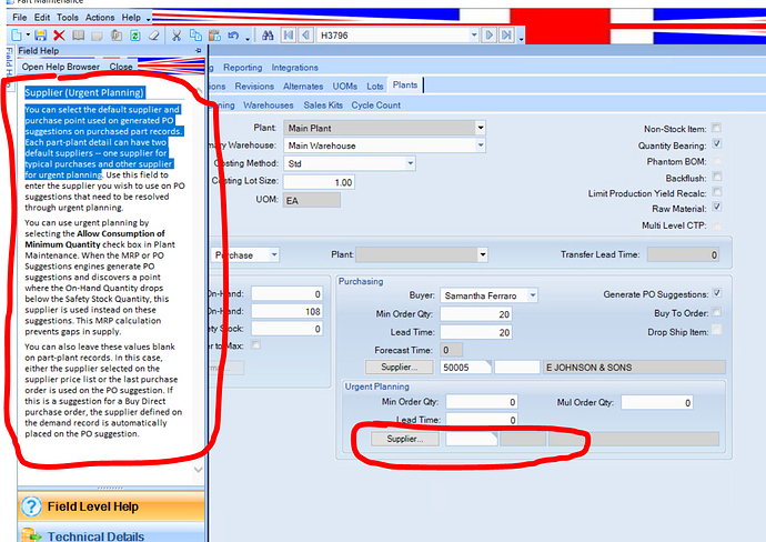

Just going to add these images too.

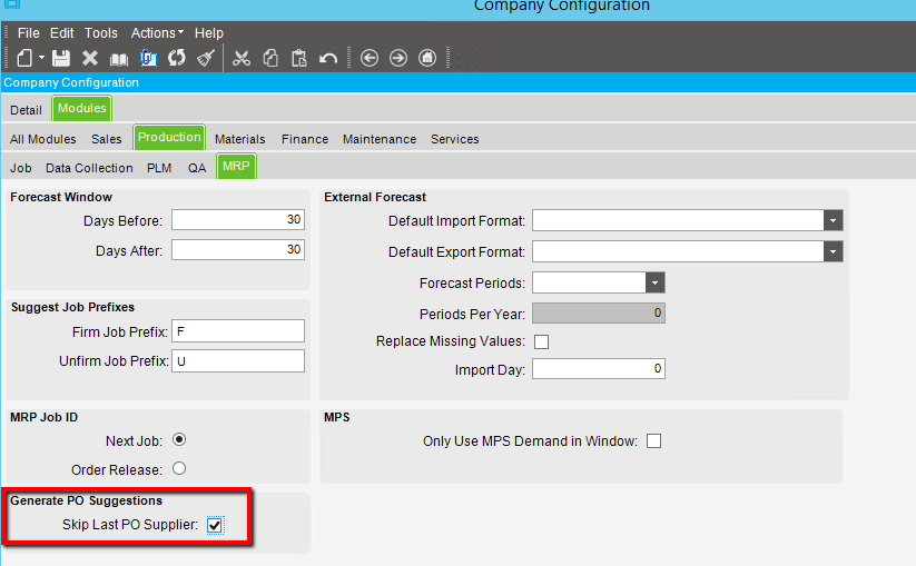

FYI… there is another setting that will override the vendor on PO Suggestions, which may be a new setting in 10. Under Company Configuration / Modules / Production / MRP there is a flag called “Skip Last PO Supplier”. Users have found that the system was not selecting the default vendor or any vendor from the hierarchy as mentioned in above posts. When not checked, the PO Suggestions process uses the last PO vendor (supplier) for the specific part.
