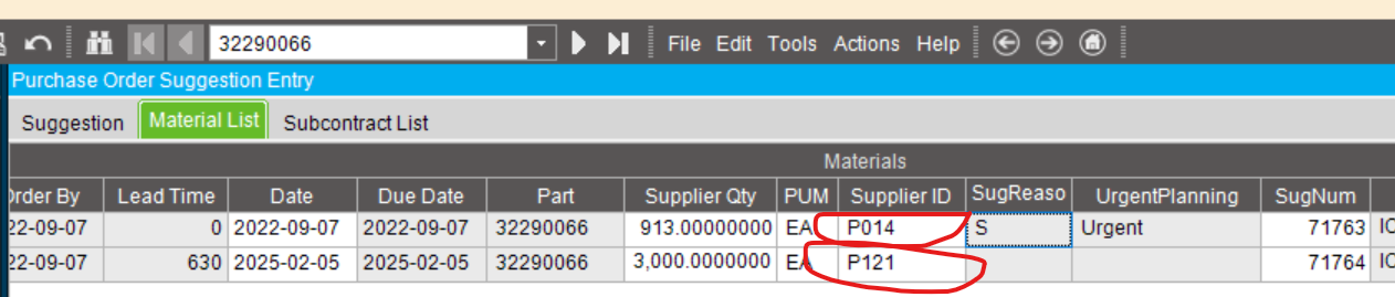

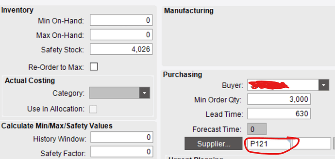

I saw 2 suppliers being offered at PO Suggestion. But, only one supplier is registered as Primary Supplier in Part Maintenance or Supplier Price List.
Why would P014 be proposed?

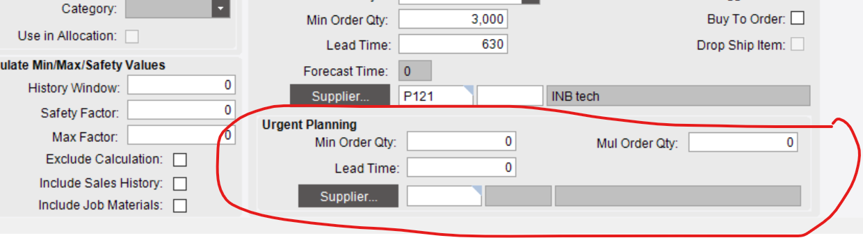

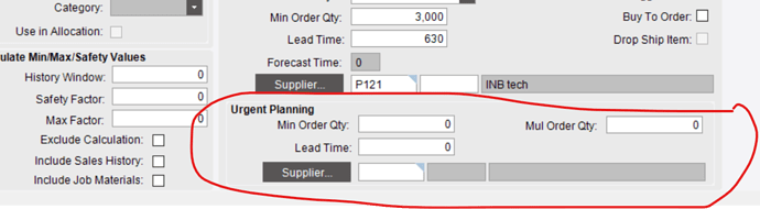

In your first screenshot the PO Suggestion with P014 as the Supplier is flagged as ‘Urgent’.
In the Sites>Detail tab of Part Maintenance there is a separate ‘Urgent Planning’ section where a different supplier can be assigned. (Just below what is visible in in your second screenshot)

I already knew about Urgent Planning. But I don’t use it. Nevertheless, 2 suppliers are suggested, So I ask here.

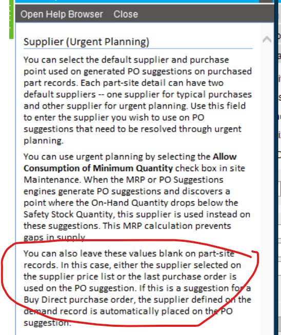

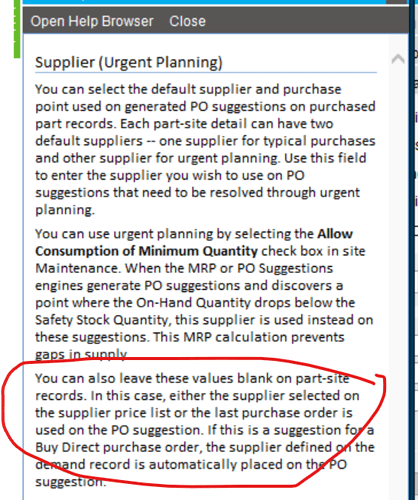

I seem to have found a close answer in Field Help. But, an unresolved question is why the last purchase order is used for PO Suggestion in preference to suppliers in the supplier price list. My last purchase order was P014, but the primary supplier in the supplier price list is P121.
