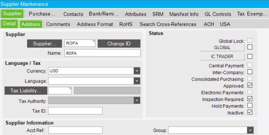

Can anyone advise the logic Epicor uses to identify the supplier on New PO Suggestions? We have a large group of parts that are using a supplier that is not only inactive in Supplier Maintenance, but the supplier is also not “approved” for the parts on any of the Supplier Price Lists. Moreover, all of those parts have been purchased before and also most recently from currently active suppliers that are approved on the Supplier Price Lists. Why is Epicor somehow choosing the one supplier that is inactive, unapproved and not the last supplier used for purchases for this group of parts?

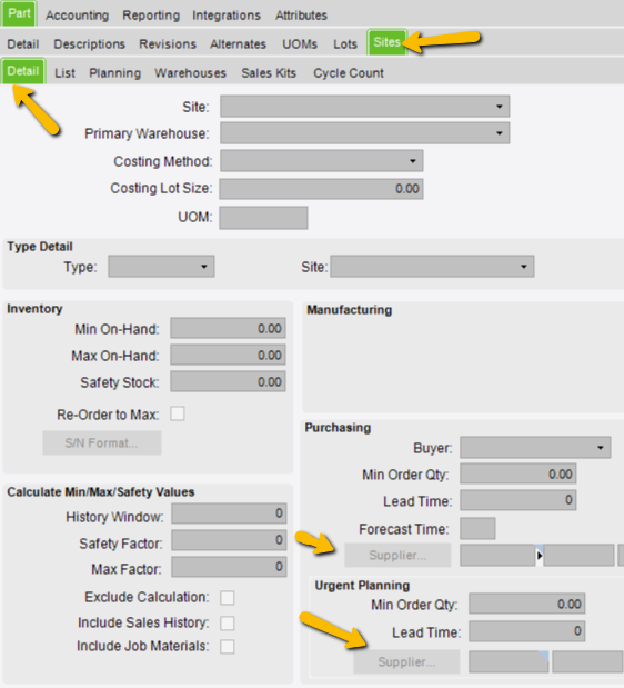

First place I would check is the Sites tab on Part Maintenance… make sure there is not a default supplier set.
Good thought, but we do not use the Primary Supplier feature for any parts, so that is not driving the suppliers pulled onto New PO Suggestions.

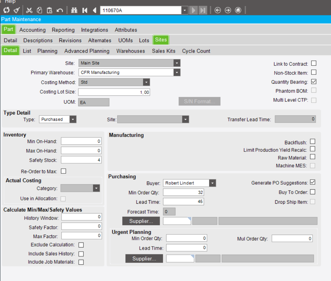

Site & that checkbox are the only items I am aware of. Can you post screen shot of part/site & PO suggestion
Sorry, Matt, but I am not sure what you are looking for. Would those screen shots help identify what logic/algorithm Epicor is using to select a supplier for PO Suggestions?
The checkbox in company config and the supplier items (bottom two arrows) are the only place I am aware to set supplier when MRP runs

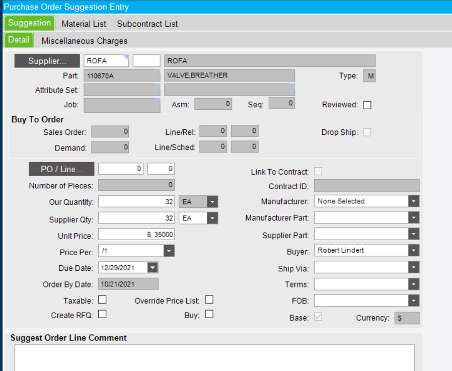

PO Sug may shed some light on the issue

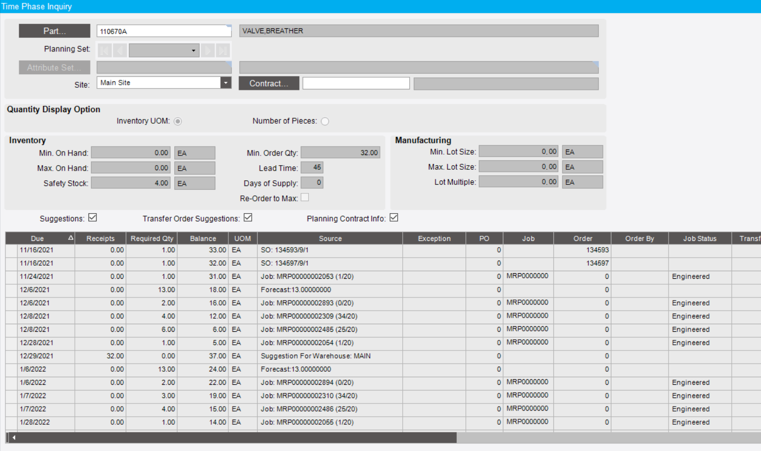

time phase as well

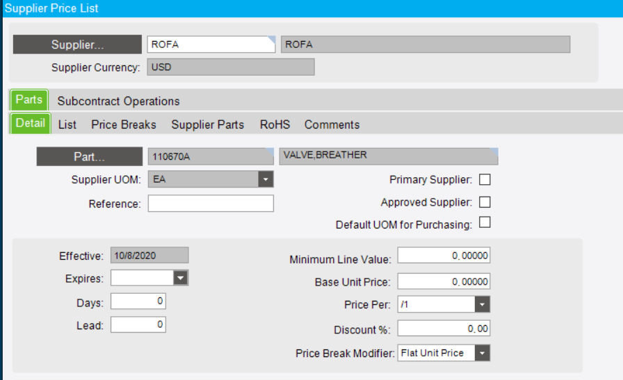

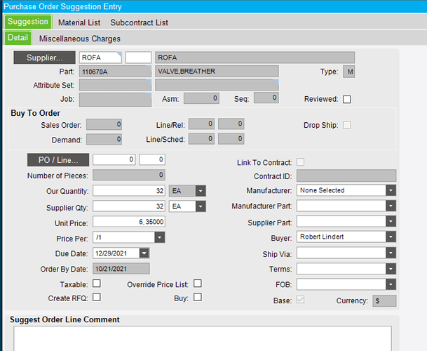

Screen shots below. As I indicated, we do not use the Primary Supplier function, so there are no suppliers referenced on our Part Maintenance screens. The PO Suggestion for this part is pulling from an existing Supplier Price File, but it is not approved. In fact, the supplier is inactive in our system.
Enter an expiration date on ROFA price list. Even if you have other price lists with more current Effective dates, PO suggestions will always use the oldest effective date/supplier until it’s expired. I’d set it to 10/9/2020 just to be sure.
