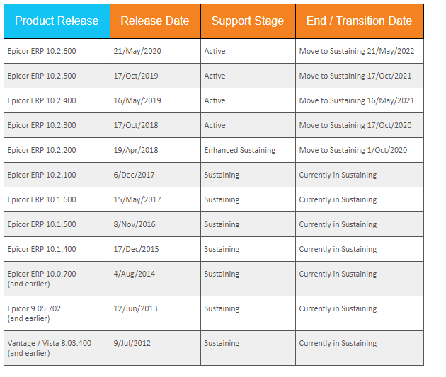

I think Epicor give each release 18 months of support. So if I remember right (please double check) 10.2.500 was released Oct 2019 and 10.2.600 was May 2020. That means support for 10.2.500 will go into sustaining support in April 2021, and 10.2.600 in Nov 2021. The 10.2.600 install will have a longer life before you have to invest in the next upgrade.

You actually get 24 months of active support. So 10.2.500 would go into sustaining support in October of 2021. 10.2.600 is active support until 2022.
Support Status: Sign In
Support Lifecycle Policies: Sign In
Epicor ERP Product Release Approach and Cadence: Sign In

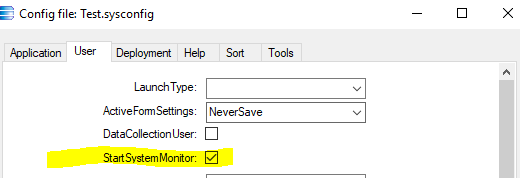

There and through 10.2.600.7 there is a client config problem where the System Monitor setting is not enabled so System Monitor does not auto start and no one gets reports.
The trouble is that the setting is in the <user> section and after the initial upgrade that section does not pick up changes.
If you fix the config file before install the issue can be avoided.
Sorry, which section of the client config is the setting in?
Just had to find it myself! Thanks @Rick_Bird

That form doesn’t look familiar. What is that? Is it something new in 10.2.600?
ConfigEditor.exe (installed in client folder), it goes back a few versions. Just an easier view to edit config files.
