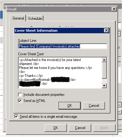

You can insert HTML into your APM email:
Depending on the version you are using the setup steps might be different but… in 2.7 the setup is here:
Output Management > Recipients
(create new or open the one you are using)
The delivery method should be listed as Email, highlight & click edit.
This opens another window, there is a checkbox labeled ‘Include Cover Sheet’ enable that and click configure.
Here you can enter the default subject (with variable placeholders) and the message and there is a checkbox for ‘Send as HTML.’ If you enable that then you would put HTML in the message and it would then be sent that way.
-Rick
www.getaligned.solutions
Rick -
I think I misspoke. I have the “Advanced Printing” not the “Advanced Print Module”.
I’ve never seen any dialog boxs like the ones you posted above (they look very “Windows-esque”, and not very “Epicory”)
