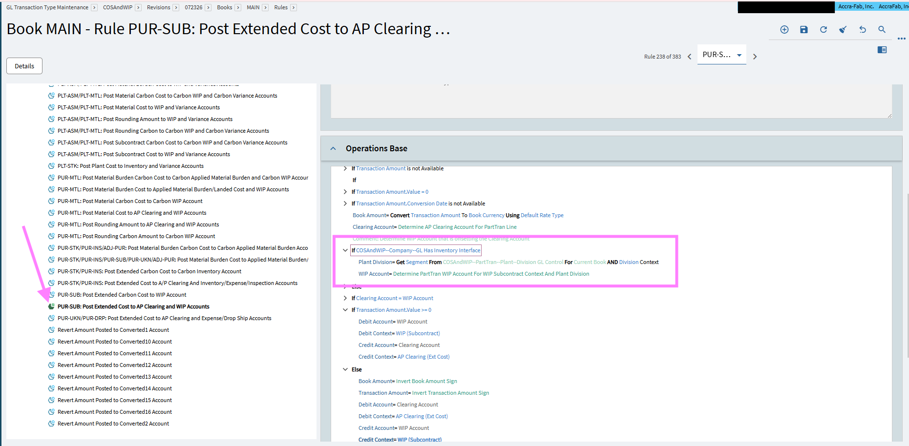

The transaction type these post under is PUR-SUB; Looking at the posting rules for PUR-SUB transactions, the only thing I see that might have something to do with this is below. I haven’t actually changed anything on this rule, I just created a new Revision to be able to see how the controls for it work.
Looking at the posting rules in general though, I’m out of my element. Is this something we should hand off to a consultant? I’ve taken a look at the transaction hierarchy guides, but I don’t think I’ve got enough accounting context to be able to configure these myself without learning a fair bit more.
For all I know, the posting rule itself is fine and we’re missing a GL Control specified somewhere else.

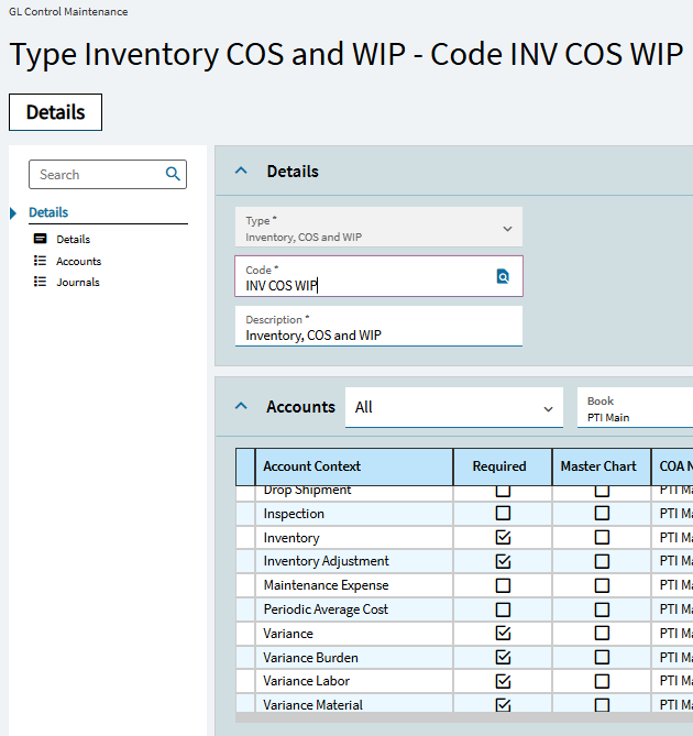

In your Company Configuration | GL Control, what account do you have in your INV, COS and WIP GL Contro?

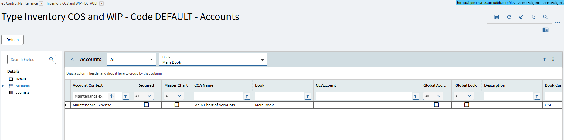

We’ve got nothing listed under Maintenance Expense.
The only two non-required Account Contexts we have specified are Inspection and Actual Cost Allocation Burden
I’m guessing this is the ‘Context’ that the posting functions refer to in places like Get Segment For XYZ?
My guess is that Maintenance Expense is the COGS charged when the Maintenance Job is closed. I didn’t have time to check this. The Maintenance Expense also exists on Equipment Type and that will override the Maintenance Expense account.
