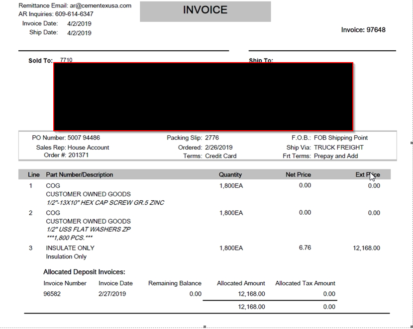

I am trying to figure out what table prepaid deposits are stored in for an invoice. This when a customer prepays on a credit card for an order so there’s no open invoice but when the balance shipped and freight charged it was a new charge on a new closed invoice.
You want to know where the info for the “Allocated Deposit Invoices” is being pulled from?

Did anybody ever identify where this data is coming from? Everything I can find points to a table that doesn’t actually exist called AllocDeposit. I found a reference in some stored procedures, but I can’t decipher where the data actually resides.

For the “Less Prepaid Deposits”, I’m seeing it has a value on the invoicehead screen for Shipment invoices (InvoiceType = SHP), if there was also a Paid Deposit invoice (InvoiceType = DEP) for the same order line, PRIOR TO the Shipment Invoice.
And, for the “Less Cash Deposits”, I’m seeing that gets populated if there was an additional deposit invoice made AFTER the shipment invoice. Though I don’t know why you’d need to make a separate invoice for the deposit if you could just receive the cash to the initial shipment invoice…
Does this align with what you found / what others see?
You want to include the ARPrepaymentTran with an outer join to show the deposit and how it was applied.
