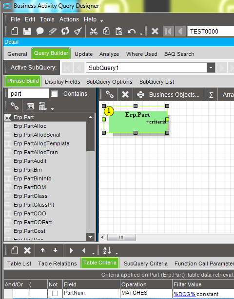

We need a fairly basic BAQ that takes a portion of a part number and returns all active price lists. Whenever I try to set the “contains” criteria, the ‘specified parameter’ option is not available. If I first set the specified parameter, then change the operation from = to contains, the parameter saves, but the analyze fails: “Cannot use a CONTAINS or FREETEXT predicate on column ‘PartNum’ because it is not full-text indexed.”
What is the best practice to do a “contains” lookup in a BAQ on PartNum?
Try using MATCHES and then enter your text surrounded by percent symbols %
For example, to find all Parts that contain DCG:

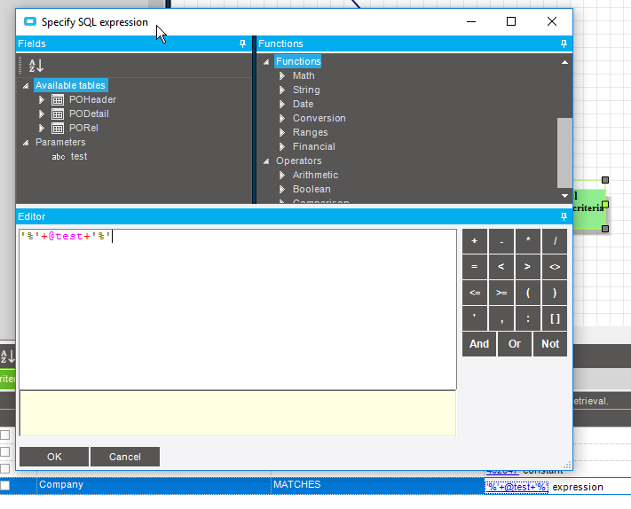

The other option if you want to stick with the parameter is to use an expression and put the parameter in there.

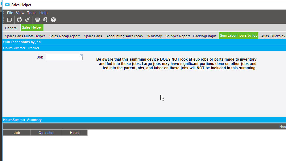

You can also “customize” that tracker and add a text label with those instructions. (customize is in quotes, because this isn’t a full blown customization) This can be helpful if the users forget something instead of calling you with questions about why it doesn’t work.
https://epicweb.epicor.com/Education/OnlineHelpFeatureSummary/Epicor%20ERP%2010/10.2.100/Help/enu/Standard/Tools_Dashboards/AddanAdvancedSearchwithRange.html
this is the help to add a tracker with a range. That will show you how to get into a customization. If you pick the label from the toolbox, you can type whatever you want in there.

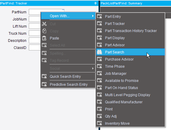

Okay, makes sense about keeping them with the refresh button. What about a button to lookup values in the advanced search tracker? (e.g. I want them to click a button that will pop open the search window to lookup and select a price list code). Right now, I have the text box working in the advanced search, but if a user doesn’t know the exact key I’d like them to click a box to open the search dialog.
If it’s a epicor field, or if you have the likes set up correctly, you can use the right click to open a part search (or whatever search). However, you should be able to get enough trackers and information on the dashboard to be as good, or better than the searches that epicor provides. Set you your tracker field to be starts with, and what shows in the grid should get them as close as the search will.
