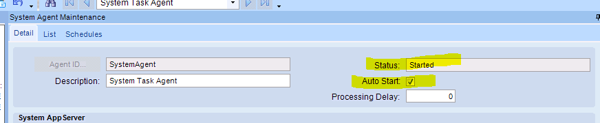

Check the System Agent. is it started? Set to Auto start?

This printing issue has been resolved. Not an easy fix as I haven’t seen anything like this in past 5 years. Tried all the above and even removing system agent and adding it back.
It was related to the SysTask table. This table contains history of print jobs/reports and somehow had records/jobs that didn’t complete or was corrupted which prevented all further printing from being released to system monitor.
